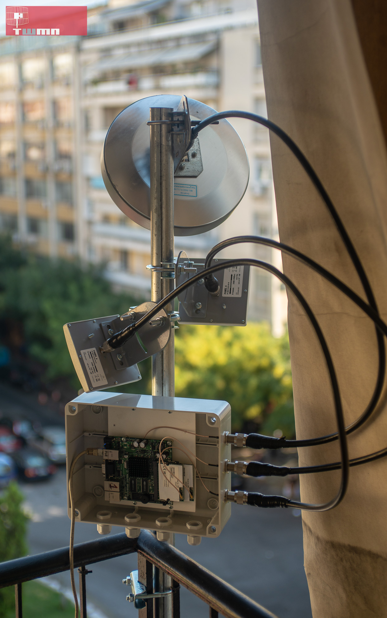

I live in the 4th floor, in a small square, with some cafe’s and bars and lot of people hanging around..
I also have an old RB133 with 3 wireless cards and 3 ethernet interfaces (do you remember them?).
Searching my warehouse, I found 2 2.4Ghz panels and one for 5Ghz. So, I’m ready to create a hotspot to offer free internet to the passing/sitting people.
RB133 will be in bridged mode of course, doing nothing except powering the wireless cards :slight_smile:
My first question is, should i give the same ssid name to all 3 APs? Different frequencies of course, but is there a problem with the same ssid ?
My second question is, since the 2.4Ghz panels have polarisation, should i have the one vertical and the other horizontal, in different directions?
thank you very much, in advance,
George

This is my wireless setup.. All interfaces are bridged and another Mt router does the dhcp and routing job..
[admin@AP-2] /interface wireless> pr
 0  R name="wlan1-2.4Ghz-right" mtu=1500 mac-address=00:0B:6B:81:7C:1F arp=enabled
      interface-type=Atheros AR5213 mode=ap-bridge ssid="twmn::FreeWifi" frequency=2412 band=2ghz-b/g
      channel-width=20mhz scan-list=default wireless-protocol=802.11 antenna-mode=ant-a
      wds-mode=dynamic wds-default-bridge=bridge1 wds-ignore-ssid=no bridge-mode=enabled
      default-authentication=yes default-forwarding=no default-ap-tx-limit=0 default-client-tx-limit=0
      hide-ssid=no security-profile=Free compression=no
 1  R name="wlan2-2.4Ghz-left" mtu=1500 mac-address=00:0B:6B:81:76:4C arp=enabled
      interface-type=Atheros AR5213 mode=ap-bridge ssid="twmn::FreeWifi" frequency=2462 band=2ghz-b/g
 2    name="wlan3-5Ghz" mtu=1500 mac-address=00:0B:6B:81:7F:6F arp=enabled interface-type=Atheros AR5213
      mode=ap-bridge ssid="twmn::FreeWifi" frequency=5220 band=5ghz-a channel-width=20mhz
      scan-list=default wireless-protocol=802.11 antenna-mode=ant-a wds-mode=dynamic
      wds-default-bridge=bridge1 wds-ignore-ssid=no bridge-mode=enabled default-authentication=yes
      default-forwarding=no default-ap-tx-limit=0 default-client-tx-limit=0 hide-ssid=no

and the final question..
should the two APs with the same ssid at 2.4Ghz, be in the same channel or in different ones?
Different.
