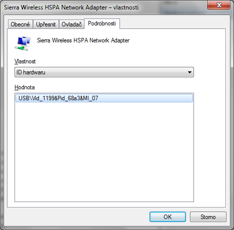

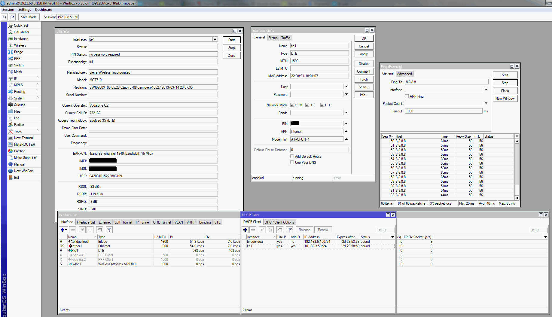

Mikrotik shows you ppp interface, because card is probably in QMI Mode. For LTE interface, you must switch card to DIP mode.
Look for PID of your card. 68A2 means QMI mode, 68A3 means DIP mode. You can switch mode by AT commands. I done it twice in the past on laptop.
AT command to switch mode:
To QMI (not probably your case):
AT!ENTERCND=“A710”
AT!UDPID=68A2
AT!RESET
To DIP (probably your case):
AT!ENTERCND=“A710”
AT!UDPID=68A3
AT!RESET
Steps:
  1. insert card to laptop, check PID card if is 68A2, install QMI drivers from Sierra site (I have Generic_M2M_DriverSetup_Build4464)
  2. find and connect to COM port of AT interface of card
  3. write commands - card changes mode. For sure you can restart laptop. Check, that card has new PID - 68A3.
  4. install DIP drivers from Sierra site (I have Build3795_DriverInstaller)
  5. flash latest DIP firmware from Sierra site (I have SWI9200M_3.5-Release13-SWI9200X_03.05.29.03)
  6. insert card into Mikrotik and look for lte interface.
