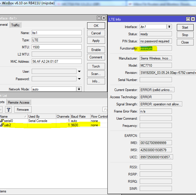

this is what I have now-
version of the modem - SWI9200X_03.05.24.00ap r5792 carmd-en-10527 2013/05/02 13:35:47
when I press info I get this (I have antenna connected to Main connector)
I get functionality -“minimum”
also - it will only work when I’m on Auto\GSM - way is it?
it shows minimum because it isn’t enabled and connected to the network.
When the interface is enabled and connected to the network it will show full when you will do info command.
About the Auto mode I am not sure, check if your SIM card supports LTE operations and if it is enabled on the Mobile operator.

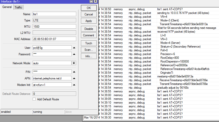

I have config
User,Pass,APN ? is there anything else?
and this is what I get in the debug - no response???
after adding
at+cfun=1
I can see now it’s running , but we still won’t connect to the internet
why?

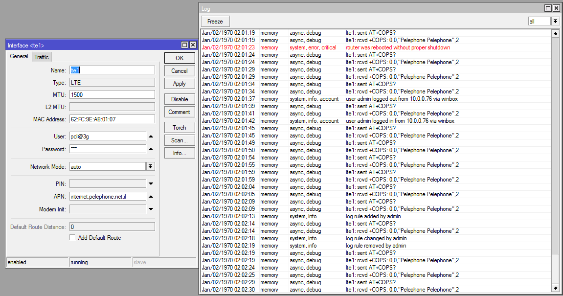

This is what I get in the log (debug+lte)
03:24:24 async,debug lte1: sent AT+COPS?
03:24:29 async,debug lte1: sent AT+COPS?
03:24:29 async,debug lte1: sent AT+GMI
03:24:34 async,debug lte1: no response
03:24:34 async,debug lte1: resetting modem
03:24:34 async,debug lte1: sent AT+GMI
03:24:39 async,debug lte1: sent AT+COPS?
03:24:44 async,debug lte1: sent AT+COPS?
03:24:49 async,debug lte1: sent AT+COPS?
03:24:54 async,debug lte1: sent AT+COPS?
03:24:59 async,debug lte1: sent AT+COPS?
03:25:04 async,debug lte1: sent AT+COPS?
03:25:09 async,debug lte1: sent AT+COPS?
03:25:12 system,info,account user admin logged in from 10.0.0.199 via telnet
03:25:14 async,debug lte1: sent AT+COPS?
from the logs it looks like the modem is locked up and not running and that is why the info doesn’t work.
