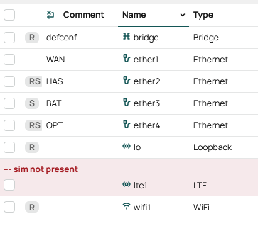

Following is our interface list:
ether1 is used for the external network.
ether2 is used for the home assistant and needs connection to the internal network, internet, aswell as the above scenario.
ether 3 and 4 are used for other devices that should have access to the internet, but should be seperated from the external network.

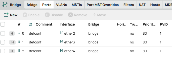

Our bridge ports look like:
The internal network uses 192.168.88.*
