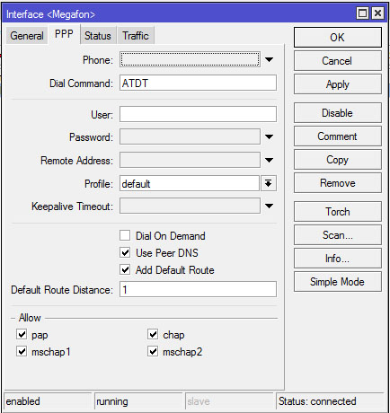

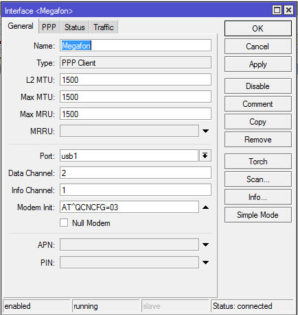

Hello. I have Mikrotik 951G router with latest Router OS 6.2 installed. I’ve connected Megafon M100-1 modem to it, made setup as you can see in attached images and setup NAT as action masquerade. Everything is OK, but modem hangs up when I try to download large files on high speed or test my connection speed at speedtest.net.
In addition. I tried to limit speed in queues. Speed was low but on maximum speed modem status was “terminated… hunged up”
