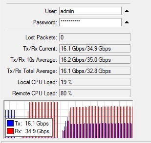

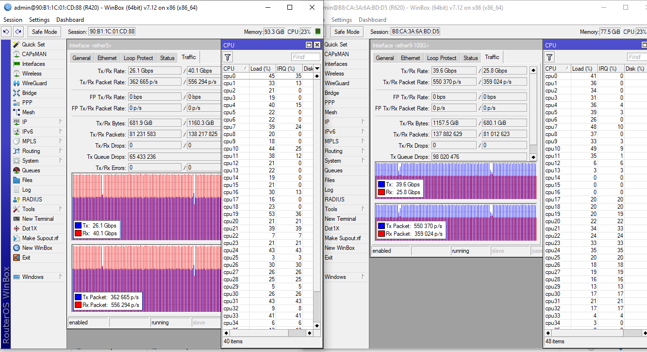

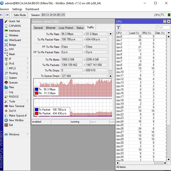

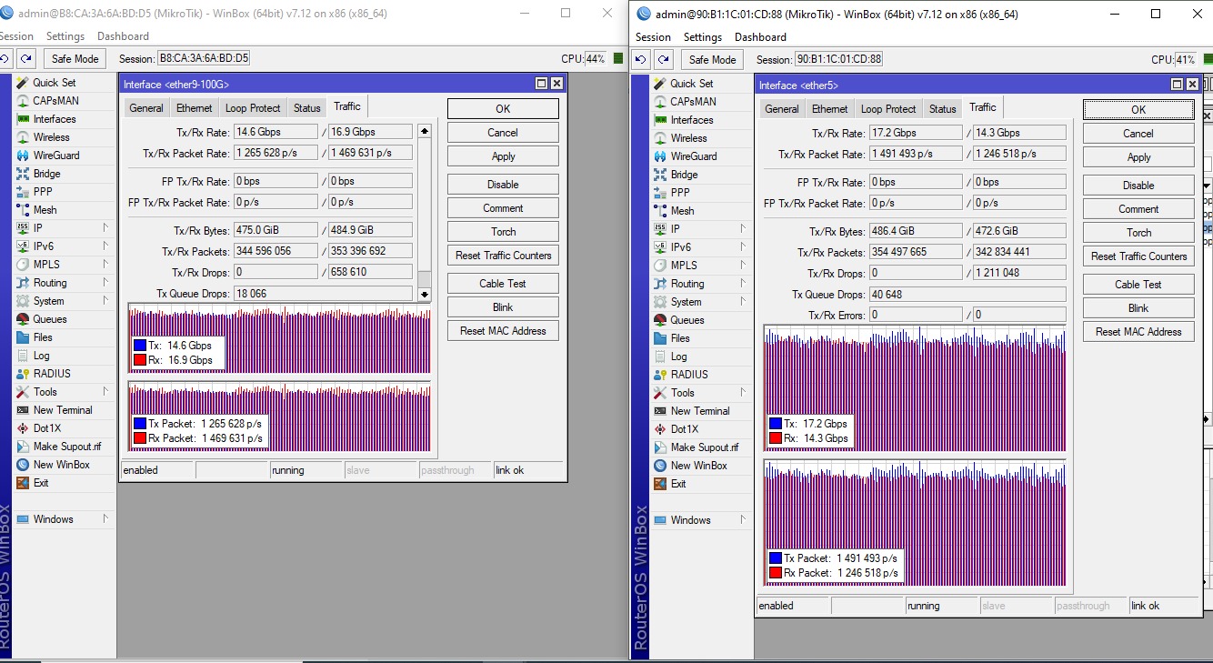

so i did some testing with bandwith test server.. and TCP running both sides.. i can only get 15Gbps aggregate traffic.. cpu wise running average 20% to 30% on both machines.. it seems to be something on the network side so i tried out.. jumbo frame set 9800 on both ethernet adapters as shown on pictures below.. but i cannot get past 15gbps..
if i do internal core test local on the server i can get nearly over 60gbps internal on the cpus TCP packets.. but on the network interfaces cannot get past 15gbps aggregate.. wondering if its software wise or hardware wise on the servers?

so i did some more testing and it looks like X16 is 64GBps max… on 8 x 8 gbps.. just need to figure out on how to fine tune this based on the CPUs cores 48threads and 2nd server 40threds it should work fine.. so far i could get around 34Gbps aggregate speeds on TCP using 100G NIC on one side but linked up in 40Gbps e and using dual port 40gbps on the 2nd server..
