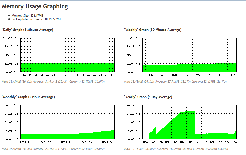

I did a quick check on some AP’s and found one which has similar ram usage to yours until July and then it reduced, I must check my weekly backup’s for this AP and note what adjustments were done, I am still using 5.20
I would start by disabling and un-installing packages or services not required,
Also edit Wireless scan list from “default” to +/- 20Mhz above and below the AP frequency ( Example AP freq=5320, scan list=5300-5340)
Multicast Helper = Disabled,…
I have found that sometimes the issues can be caused by a connected router and not the effected router ?
So from this I have adopted a network wide policy of “if it’s not required in my configuration – then disable or uninstall”
Below is screenshot
