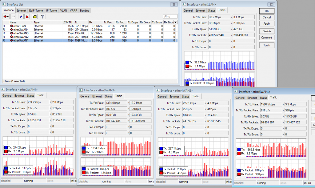

At my friend’s setup, All 4 DSL Lines were of un equal speed, 2 Lines with higher n 2 with lower bandwidth links, that’s why you are seeing un equal link speed in the screen shots. However
However if you want to force MT to use one link more then other, for example WAN4, you can add more PCC lines but assigning the same two marks to a specific link , something like

This link really helped me , I have now merged 4 DSL lines, (10Mb each line) and I am now getting average of 35/36 MB in peak timings. Previously I was using TPLINK 4 wan load balancer but it had issues with secure sites , Download broken and streaming, but this pcc method gave me best performance (around 95% ok) so far.
