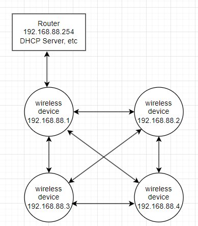

Here’s a basic diagram of what I have right now -

Note that I also have a routerboard router in the mix, connected to one of the wireless devices, and it has a DHCP server on it. That ethernet port is in the mesh as well:
/interface mesh
add name=mesh1
/interface mesh port
add interface=ether2 mesh=mesh1
And the DHCP server is running on mesh1.
So far, so good. All the devices mesh with each other, get addresses from the DHCP server, and they can talk over IP.

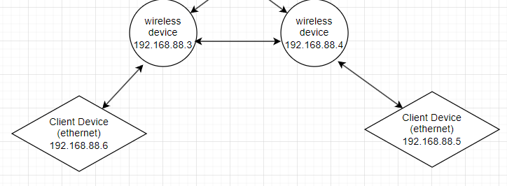

Currently, I have the ether1 interface as a port in the mesh in each wireless device, so when I connect something to said port, it can talk to the rest of the mesh and gets an IP on the same subnet:
So far, this is alright, but it’s still a bit centralized. If the router at 192.168.88.254 (or the wireless device it’s physically conncted to) falls off the network, nobody will be able to talk because nobody will get an IP address.

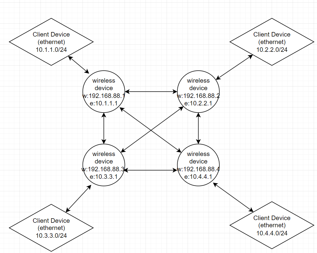

Finally… routing. Let’s say the network now looks like this:
I’d like to not require a bunch of static routes on every device… so I assume I’d need to use some sort of dynamic routing protocol. If that’s the case, what protocol would work over a wireless mesh and are there any special considerations?
