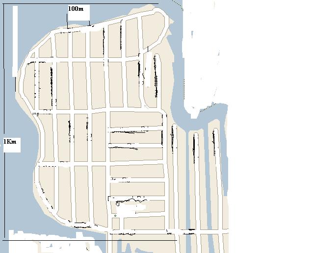

This is the map of the community.
How many AP are needed and how far apart they need to be so there is good coverage?

How about some real world examples… in a typical dense node deployment with 5ghz back and 2.4 20mhz access, for indoor cpe and outdoor wifi, we typically deploy nodes approximately 400m apart when using 5db omnis. This environment is typical in my local area where you must zigzag down the road from one intersection to another because of tree overgrowth and even then it normally isn’t los between blocks.
When we change this to a sector on a higher location (25m+), i.e., your water tower (though you mention only backhauling to this location), we see up to 900m possible with indoor cpe’s, though it is hit or miss on the longer shots. Typically we deploy the indoor cpe near a window with a window splatch antenna facing the nearest ap.
