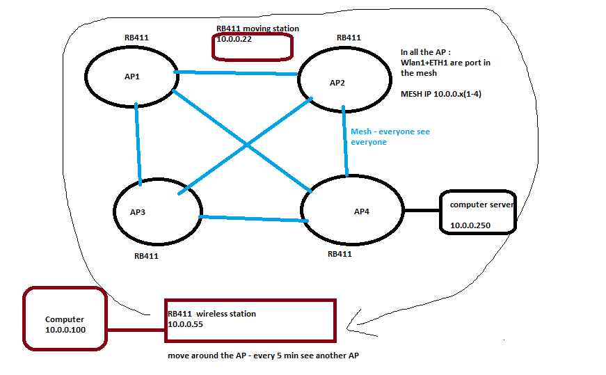

I have 3 rb411 work in mesh mode - just fine

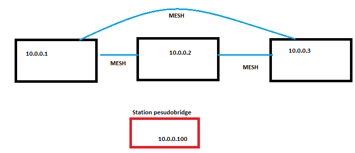

when I take another and try to make it work as a station - it all goes down
I can only get connection from the station to 1 unit - can’t see the rest
but if I connect a computer it’s work and I can see all 3 units
what am I missing?
maybe some firewall rule?
If you are wanting the MESH to work across the wireless links, then WDS will be more efficient. Station pseudobridge will give lots of grief. :smiley:
So what do I need to define in the “mobile” router?
WDS slave?
Here is a good example of how to use the WDS with MESH:
http://wiki.mikrotik.com/wiki/Wireless_WDS_Mesh
I have done as it said in Model 1 : Wireless WDS Mesh With Mesh Interface
and I can see the computer\mobile phone connect to all 4 AP ,and there is roaming.
but I want to be able to connect using another RB - and this is not working
my question is what I need to config in the “station” RB to make it work ?
Thanks ,
if I do this in a bridge and not mesh -it working
I want the computer to see all AP,computer server,moving station…
