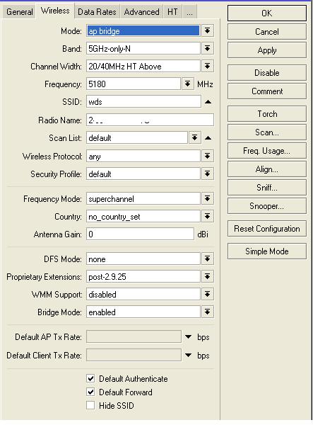

I configure mesh and hmwp+ on 3 OmniTIKU-5HnD
Mode : ap-bridge
Wireless protocol :any
band : 5GHz-only-N
channel Width : 20/40MHz HT Above
SSID : wds
HT Tx and Rx channel : tik all
Ht guard interval long and tik all 0-7 on the HT AMPDu
when configure with NV2 disconnect all connection on mesh

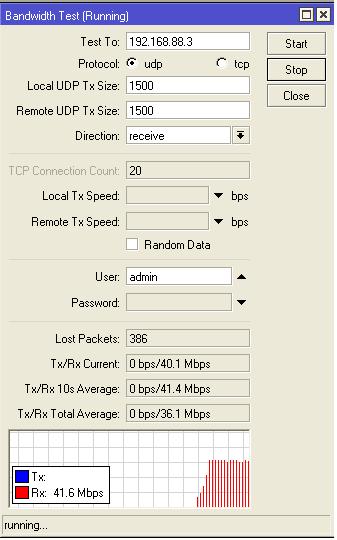

problem : maximum bandwidth test for 1m is 40Mbps
connect sxt to mesh bandwidth test is 112Mbps
Hi reza,
did you manage to resolve this issue? I have the exact same problem, the speed seems just too slow. I can’t get more than 40mbps UDP, but connecting P2P i get nearly 200mbps.
