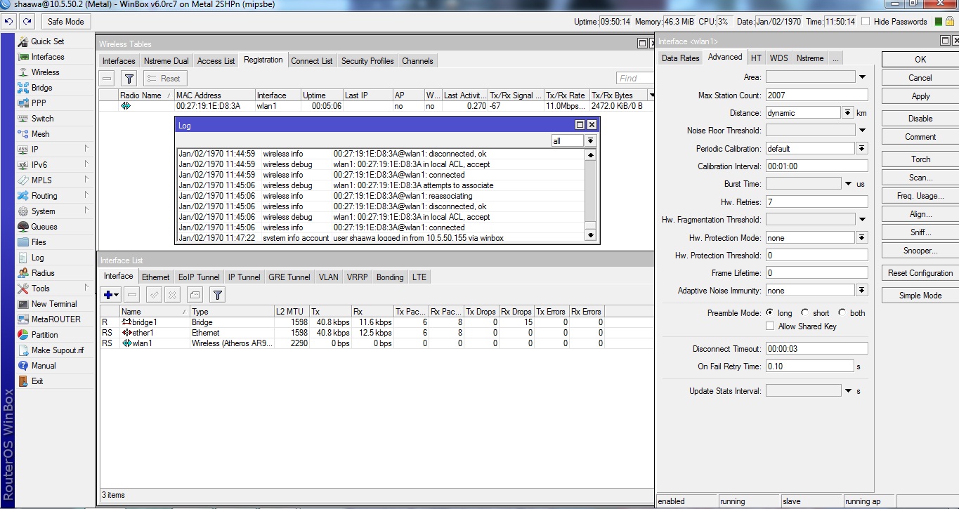

Can at least one of you show the registration table printout please?
I have the same problem when I install the metal rb outside, but inside it works great even when signal is about 100db.
if the clients are not so far away then you can switch the distance setting from dynamic to indoors.
