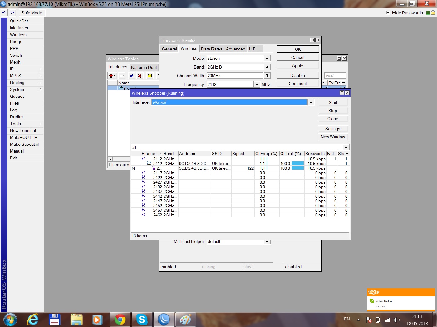

I have problem with Metal 2SHPn, Snooper see only one channel like on pic.
Can somebody explain what happened ?

why are you in 802.11b mode?
…because he liked how internet worked through dial up modems and wants to feel that again :laughing:
Seeing that the only visible device is with very weak signal, it could be possible your Metal has some problem. Otherwise, have you configured anything in the scan-list?
because after some test I return default config… Not matter for scan…
Thank for reply…
I think problem with receiver :frowning:
Go to /System Health and tell us the temperature of your unit. I have had problems with Metals and the most telling stat if it’s gone bad is the temperature. When mine go bad they climb to about 50C and the radio quits working.
This is not related. metal can work with 60C or more. 50C is not even hot, it is warm to the touch.
OK then.
Thanks for reply,
Problem was with N connector on Metal.
