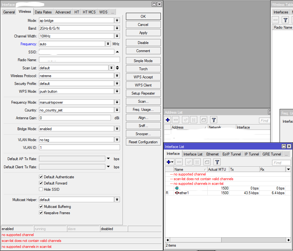

I have just deployed a Metal 52 ac and am using it on the 2.4GHz spectrum. Setting it to 10MHz Channel Width causes errors:
I am aware that Mikrotik ac does not work on 10Mhz. But I’m not even using AC Band or 5GHz. Is it possible to fix this or will I have to use Metal 2SHPn’s?
Thank you in advance.
-Sam
The hardware does not support.
Channel Utilization
20/40 MHz
20/40/80 MHz
https://www.qualcomm.com/products/qca9889
Sent from my SM-N910C using Tapatalk
