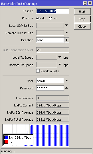

Hi, I dont know what is problem with Your setup, maybe channels (band) is to crowded, but I just wanted to show what speed results I get with two Metal 52 AC on 2.4 GHz N / 40 MHz / 1 chain on 5.2 km link - see Print screen in attachment.
You don’t need ac device for that. Such speed is achievable with whatever N device. You should not keep admin user in the system, replace it by your own not common user.
Yes, but that is purpose of dualband device, if You want / have an antenna for 2 GHz You set it up on 2 GHz, but whenever You want / need to work on 5 GHz You switch it to 5 GHz, that is the point of dualband devices. I set it up on 2 GHz because I already had 2 grid antennas for 2 GHz, later I will get 5 GHz antennas, and switch to 5 GHz.
Admin user wise, yes I know, and I am in transition of changing username to all my MikroTik devices, thanks.
