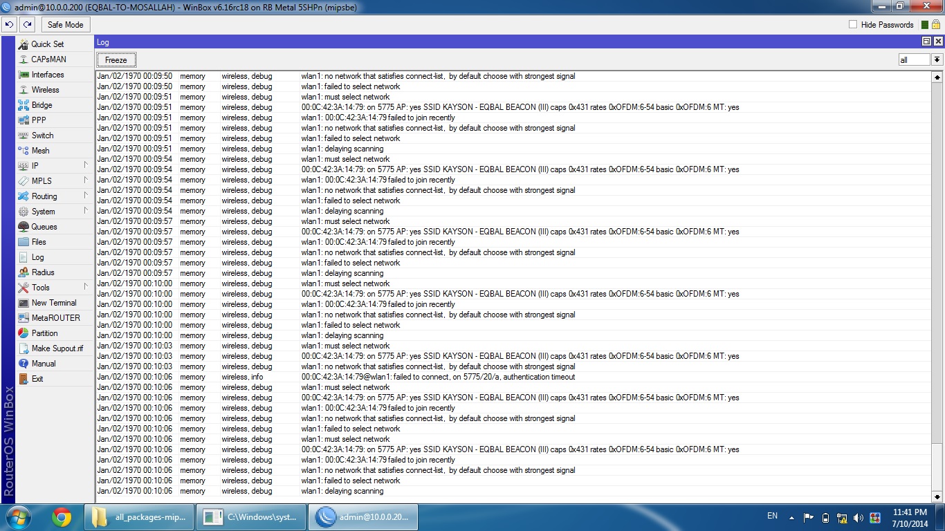

ps: wifi logs only show : failed to join … by default connecting to strongest …
this is wireless log
TKIP are unsupported on only-n mode.
