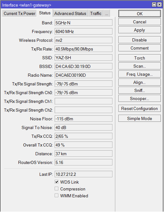

i needed help my station side reseive 40 m but my station tx is bad ccq for tx 3 to 10%

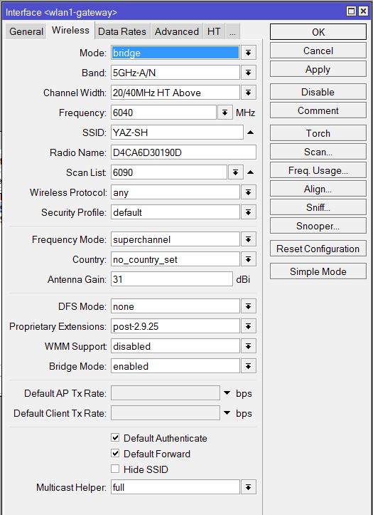

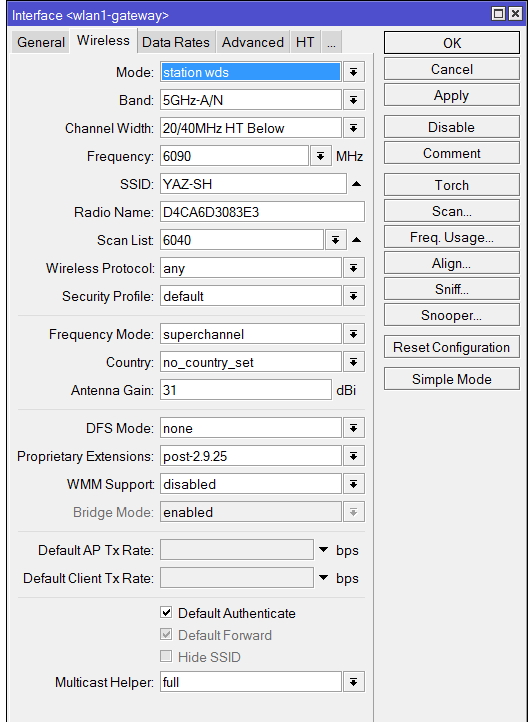

and this is a pic of my setting
see if there is any wrong with my setting
set the same freq and choose same above ore below on them both.
Why do you use that freq? do the antennas support that ?
I think your setting is wrong. If you select Frequency 6040MHz you need to add this frequency on other side to Scan List. -79/-75dB is not a good signal level. We like to see -50 to -55dB as perfect link and to -61dB as acceptable link. Everything over 70dB is wrong for us.

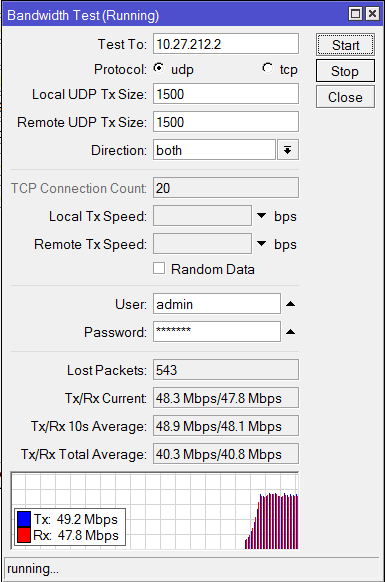

my ap and my station just ptp link with no pppoe server or pppoe client . iam trying to log in with pppoe via windows and it dosnt work with nv2 as a protocal but it work fine when i use nstrem
and her image to explain the case
Try Bridge Mode: Enabled to AP and Station Bridge to Client.
