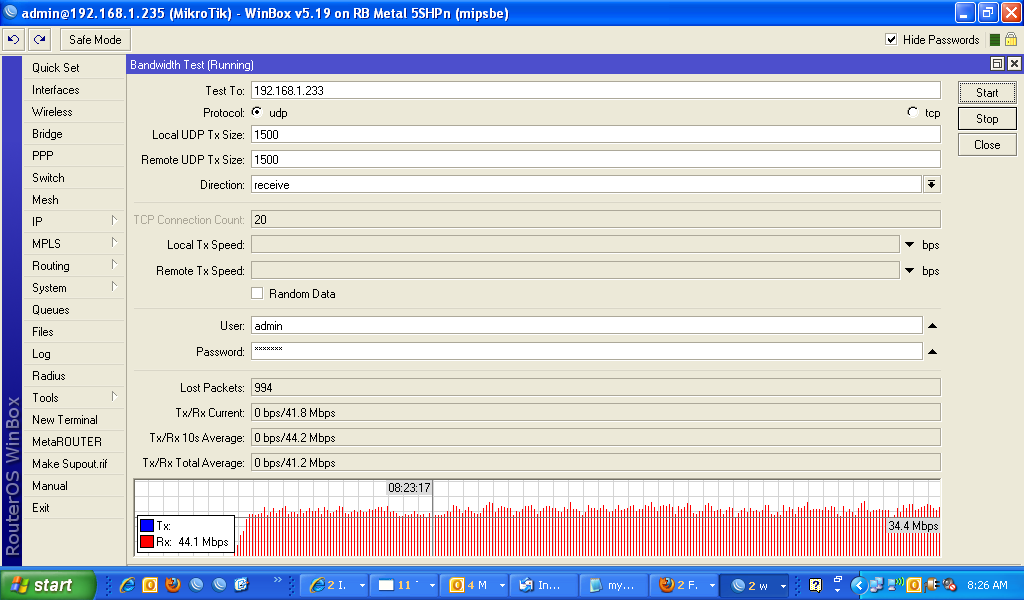

Hi folks,
Just used the Groove METAL and WOW…it is a balastic missile.
Distance 40 km and signals less than 50/50 with just 27 dbi grids.
Amazing stuff so far. Dunno what so much power does to the rest of AP’s on my tower.

1-3 ms Tested bandwidth 15 mbps
15mbps for -50 is slow.

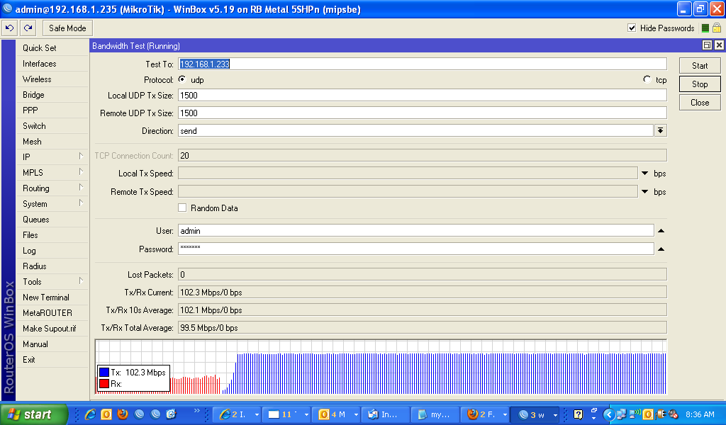

I did not test it on bandwidth test. I have posted results for a 30 km link on Groove 5Hn only and even that is better. In this case I just needed to deliver 15mbps.
bandwdith test posted. i am sure it will get better with some tweaking on either sites.
This makes me desire some more RAM atleast 128 on the Groove Metal. A faster cPU close to 800Mhz.
100mbps at 40km .. who else can match … ![]()
