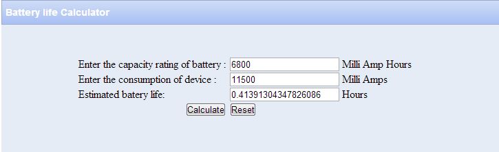

Metal 5SHPn uptime for 2 x 12V 6800mah battery...
understand that Metal 5SHPn Power consumption is 11.5W max.
if i using the 2 x 12V 6800mah, how long the metail 5SHpn can be up as i try to get some calculator to calculate for it but get confused.
appreciated for the help.

Metal 5SHpn max consumption is 11.5W which = 11500mA…
according to the online website calculator…
1 Battery can only power up the device up to 0.414 hours only…
2x12V=24V
11.5W/24V=0.4792A
6.8Ah/0.4792A=14.19h

11500mA=11.5A
Are you sure that is normal for your wire?
Hi, i just refer to the routerboard website which it mentioned max power consumption is 11.5W…
then i use the Watt to mA conversation it shown me the value is 11500mA…
and i getting the wrong idea?
P(W)=I(A)xU(V)
I=P/V

You have an unique Metal 5SHPn with 1 volt of supply only!
Dear Deac…
in fact, i really have no ideal about this…
if you don’t mind, you can tell me more which i will learn from it…
1W = 1A * 1V
You can’t “convert” watts to amps and leave the volts out as 0 volts leads to 0 watts, no matter how many amperes you have :wink:
