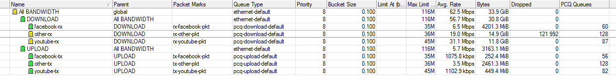

This section is for traffic categorization for download and upload which will be used later with queue tree:
For Downstream Traffic
add action=mark-connection chain=forward in-interface=ether1-wan new-connection-mark=client-downstream-conn passthrough=yes
add action=mark-packet chain=forward connection-mark=client-downstream-conn new-packet-mark=client-downstream-pkt passthrough=yes
add action=mark-packet chain=forward new-packet-mark=rx-youtube-pkt passthrough=no src-address-list=youtube in-interface=ether1-wan
add action=mark-packet chain=forward new-packet-mark=rx-facebook-pkt passthrough=no src-address-list=facebook in-interface=ether1-wan
For Upstream Traffic
add action=mark-connection chain=forward in-interface=all-ppp new-connection-mark=client-upstream-conn passthrough=yes
add action=mark-packet chain=forward connection-mark=client-upstream-conn new-packet-mark=client-upstream-pkt passthrough=yes
add action=mark-packet chain=forward dst-address-list=youtube new-packet-mark=tx-youtube-pkt packet-mark=client-upstream-pkt passthrough=no out-interface=ether1-wan
add action=mark-packet chain=forward dst-address-list=facebook new-packet-mark=tx-facebook-pkt packet-mark=client-upstream-pkt passthrough=no out-interface=ether1-wan
P.S. Method 2 did not work if i omitted the in and out interfaces. In this case for downstream traffic in-interface should be ether1-wan and for upstream traffic, out-interface should be ether1-wan for method 2 to work successfully.
I don’t know why…i have to investigate.:slight_smile:
Queue Tree looks like this:
Best Regards.
