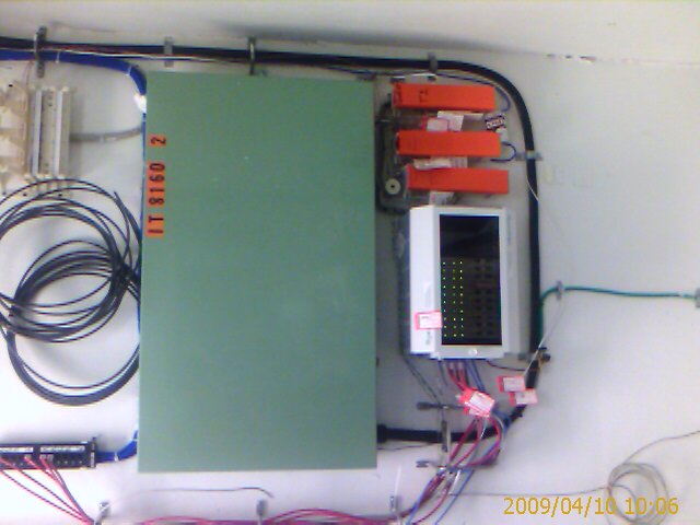

Address:
MicroAge
8160 S. Hardy DR, Tempe, AZ 85284
Google earth it..
We get Ts… just Ts…

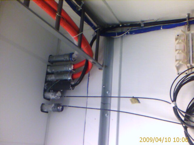

Here is the POP… there is a second POP outside…
Here in the US we get Ts… just Ts…
We colod our phone switch and some of my equipment for about a year in one of the local telco’s cages recently they ran Ts into the cage, not Ethernet, Ts…
