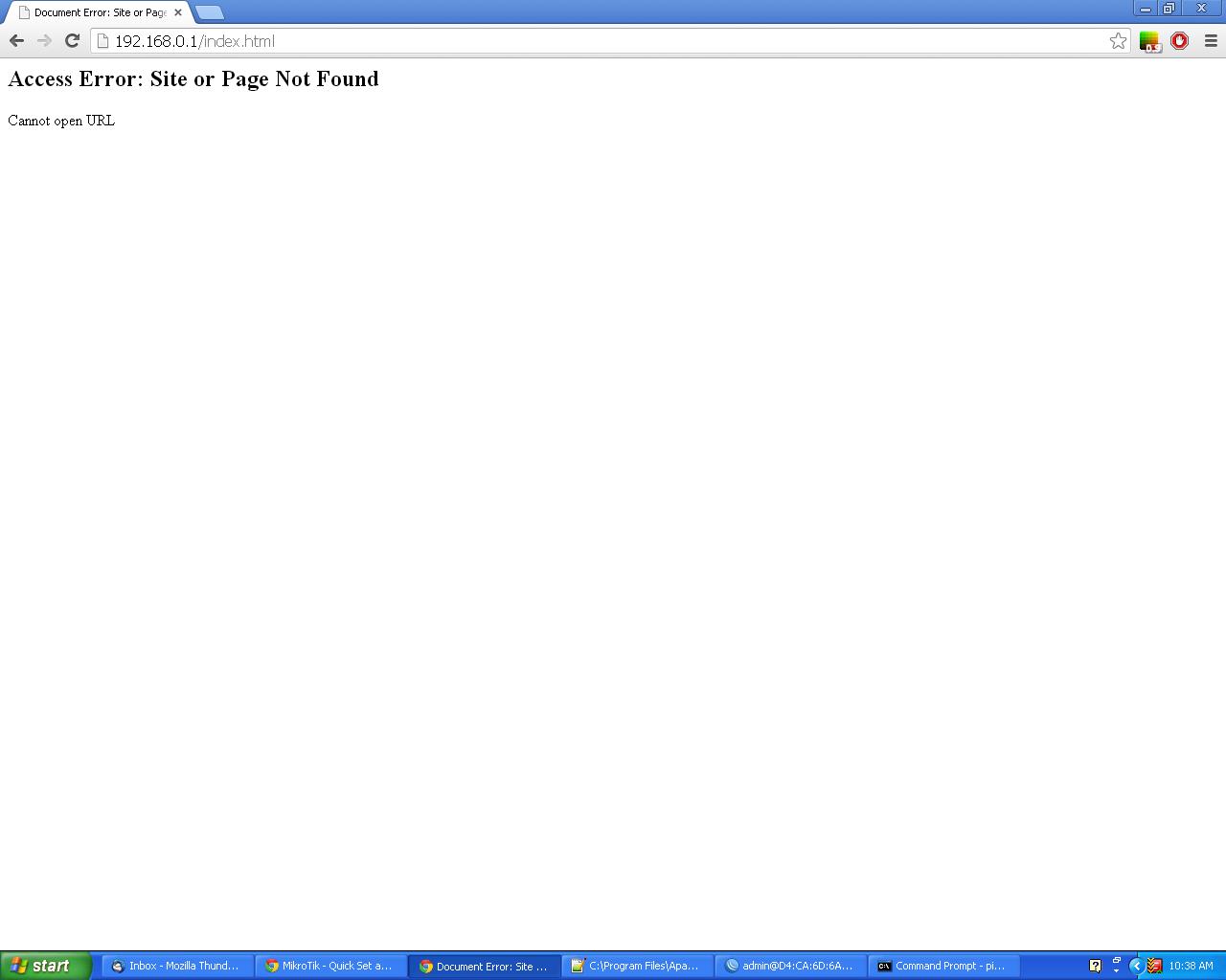

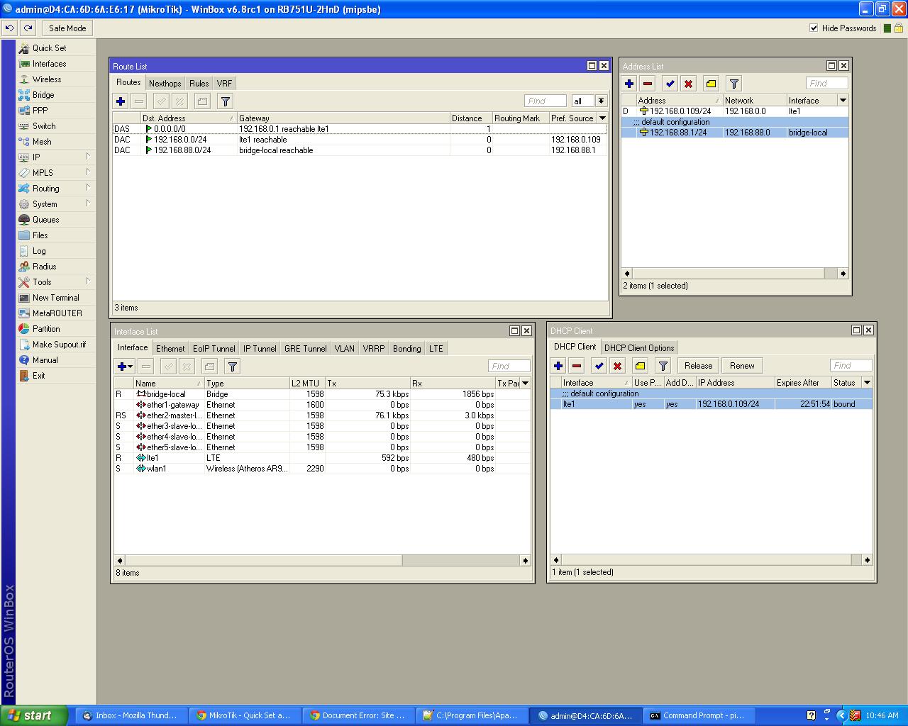

Hi guys,
Here are some screenshots regarding the issue. First is the screenshot of the web config.
I got this ZTE Modem from our local ISP maybe they’ve disabled the web interface of the modem?
The second screenshot shows the config of RB751u.
Thanks.
also don’t forget to add a NAT (masquerade rule with out interface lte1) rule so you could access the LTE modems webpage.
Hi Uldis,
I have tried that setup but I can’t access the ZTE webpage either.
I also tried connecting the modem directly to my desktop but still I can’t see the webpage.
