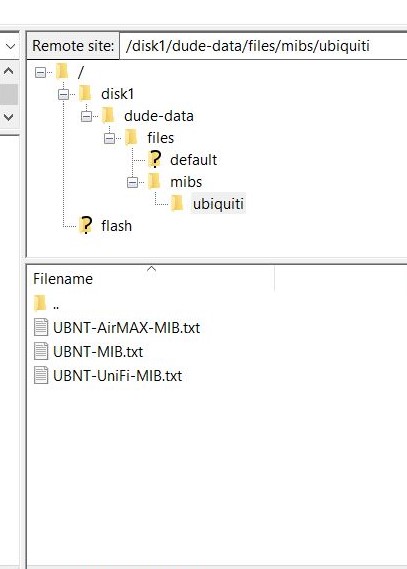

With me it was the Ubiquiti MIB’s This is how I did it.
This is my current setup.

It does not look like you have placed the MIB files in that folder. Where did you put them?
I was an idiot. They are listed in there it’s just that the Siklu mib is called “Radio Root Bridge” and not Siklu. So I was missing that.
