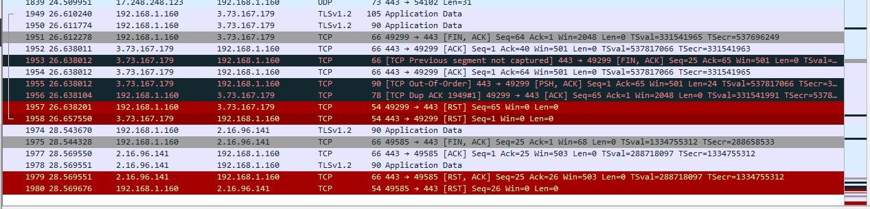

Meanwhile I captured the traffic with wireshark and I see TCP connection issues.

If aggressive TCP timeouts cause the issue why it isn’t constant? And I tried to reset all connections from Tracking/Connections tab and it doesn’t solve. At least for a short time it should resolve if it’s a timeout issue, I guess.
