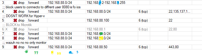

What i do on first router: drop - forward on ports (that works between ports)

Is a simple firewall that works green, yellow, blue are rules to block access to other microtik devices

add action=drop chain=forward comment="DOSNT WORK for Hyper-v" dst-address=\
    192.168.88.100 dst-port=22 protocol=tcp
add action=drop chain=forward comment="BLOCK to Microtik" disabled=yes \
    dst-address=192.168.88.1 dst-port=22,80 protocol=tcp
add action=drop chain=forward dst-address=192.168.55.0/24 src-address=\
    192.168.88.0/24 src-address-list=""
add action=drop chain=forward dst-address=192.168.99.0/24 src-address=\
add action=drop chain=forward comment="wazuh no no no only monitor" \
    dst-address=192.168.88.20 dst-port=443,80 protocol=tcp src-address=\
    192.168.88.0/24

Terminals located on the same network segment and using the same interface are running at Layer 2. Depending on your network topology, communication between them may not need to go through the interface you configured, thus rendering your firewall rules ineffective.
Your routers are actually switches. Normally this is a problem as they don't route very fast,
but for this it probably works well.
You can put ACL's into the switch rules table, to drop the traffic you want dropped.
Something like.
/interface ethernet switch rule
add dst-address=192.168.88.0/255.255.255.0 dst-port=22 mac-protocol=ip
new-dst-ports="" protocol=tcp src-address=192.168.88.0/255.255.255.0
switch=switch1
And before these rules, add some allow rules.
Note: new-dst-ports="" means drop.
https://help.mikrotik.com/docs/spaces/ROS/pages/15302988/Switch+Chip+Features#SwitchChipFeatures-RuleTable
Yeah traffic is not going to hit the router firewall, unless it crosses a IP subnet (in which case the traffic is routed). But if IP address are in same subnet, then ARP will resolve it on the VM hypervisor.
A few possible approaches:
  1. Use a IP subnet for each VM client. So you assign each VM guest its own unique subnet, and assign the default route on router. Since each device will have to use routing to get to another device, it will go through the firewall. But you can't use DHCP (or at least you'd need to associate MAC address as static leases. Also, you'll have a bunch of IP subnets configured in a few spots. And, since all hosts are on same bridge, broadcast and L2 remain open... so possible to block ports like SSH but "less secure" than 2 or 3.
  2. On VM host side, wire each VM guest as a port to CHR. On VMWare, you need a vSwitch per device (IDK Hyper-V terms, but also needs similar). And similar to 1, since each need their own IP subnet, although port isolation in bridge). But this forces all L2 and L3 traffic to CHR's firewall
  3. On VM host side, set a unique VLAN per VM guest, and set CHR as a trunk port to vSwitch. Here you'd need a n VLAN matching VM guest network VLAN ID. Also need IP subnets configured like 1.
