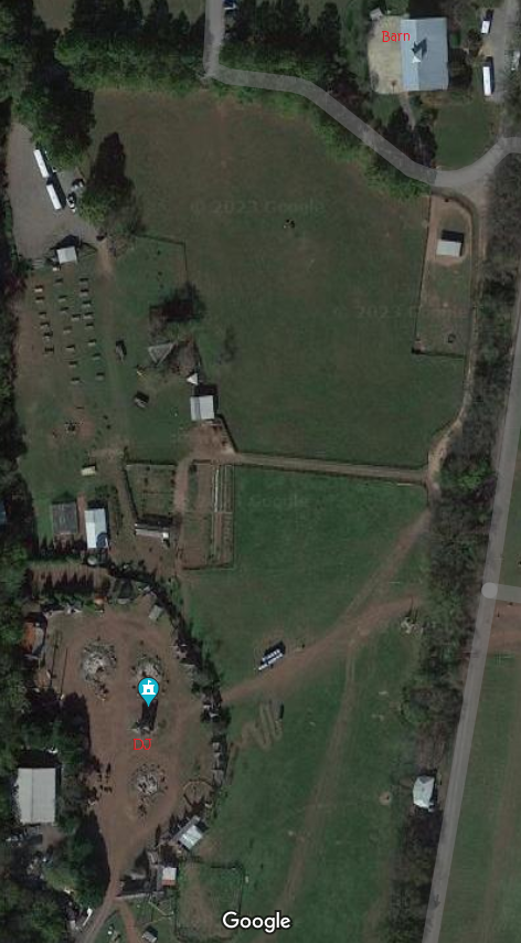

I have 2 at an event space that cover 58,000 sq feet with ease.
But I was able to make a wifi call using my Pixel 6 from 1052 feet away. My laptop also connected at that distance.
Sweet performance!
Back when I “learned the hard way” about Mikrotik AC devices… I could connect a device to a wAP AC at maybe 110 feet. But the air better be completely clear of any other devices on that channel.
The event space I took over in October… had two UAP AC Mesh Pros. They were being asked way too much. Ended up in the trash 3 days after opening.
The point in the lower left, is the DJ Booth at the center of the midway. iPads and square devices are used all around the midway. That’s what I needed to cover.
The Barn at the upper right is where the ISP comes in. I was inside the barn connected to the North Facing WAP. Made a wifi call when I was outside on the West side.

110 Meters = 360 feet. That’s roughly triple the useable distance I observed.

My reference to the UAP AC Pro Mesh was what was in the event space when I got there. 2 of them couldn’t even cover the mid way. They were trashed and The Cambium XV2-2T (x2) replaced them. I provided the photo to show just how far away the Cambiums could actually maintain a link.
