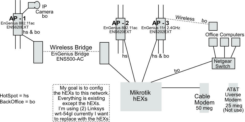

Pictures is worth a 1000 words - this is what I’m trying to accomplish and it’s a challenge.
Any help is appreciated!
I need some direction.
Looking at my network diagram. Let me know if I’m on the right track?
AP-1:
-VLAN for Backoffice (say VLAN10) for the IP camera.
-Not sure what I need for the Hotspot? I think leave open for usermanager on SSID (myhotspot).
AP-2:
-Just for Hotspot. So leave open for usermanager on SSID (myhotspot).
AP-3:
-VLAN for Backoffice computer (say VLAN10).
-SSID (myhotspot) for HotSpot (open for usermanager)
So create a VLAN for just BackOffice and not the HotSpot?
I’m I on the right track? Please advise?
There’s nothing clearly wrong with the image, and I’m sure it can be configured like that. But there’s usually more than one possible solution, and to decide which one is the best is difficult without knowing all details about existing network. And it’s not easy to explain those accurately to someone else, not leave something out, etc.
Whether you put one network in tagged VLAN, or the other, or both, doesn’t make much difference. It also depends on your other equipment, what’s possible. I’d suggest to continue reading about VLANs, do some experiments (you have two free routers for that) and once you get hang of it, it will become clear what’s best for you.
Sob the diagram is my existing network, running on (2) Linksys routers.
I just need to know how would you set this up on the Mikrotik router, so I can only use the Mikrotik router and ditch the Linksys?
I don’t see where exactly you have two routers, it looks like one should be enough (but there’s no major difference between one and two, you’d just spread the config between them). So one independent port would be WAN, and the remaining four would go in bridge. Office can be directly on bridge untagged and hotspot in tagged VLAN (you need to configure your APs to tag hotspot traffic). So bridge will be LAN interface for office and VLAN interface will be where you add hotspot.

Sob - the diagram doesn’t show my currently in use (2) Linksys routers. I want to replace them with the hEXs.
I currently have bridged all Ethernet ports on the Mikrotik to the WAN - (1) bridge.
If I setup like you suggest - will my office be protected from the Hotspot?
Tagging Hotspot on (3) AP’s? Do all AP’s get tagged with the same id? Like VLAN10 or can they have different numbers on each?
Also - what about the IP cameras? Should I use IP bindings through the Hotspot? I really want them on the office network, but how?

Router routes everything it can, so you need to use firewall rules to block access between networks you want to isolate from each other.
I’d just put all hotspot traffic in one common VLAN, unless there’s a reason to do it differently.
And IP cameras depend on your AP, configure it to not put them them in VLAN and they will be part of main untagged office LAN.
Have no experience using it, but it should do the work.
But once again - it MAY help, if most of your traffic stays inside separate vlans.
If most of you traffic is from LAN to WAN and back, and from one vlan to another, then it won’t make real difference.
So I think, you’d better start with just a hEX S, but be prepared to add a switch :slight_smile:
