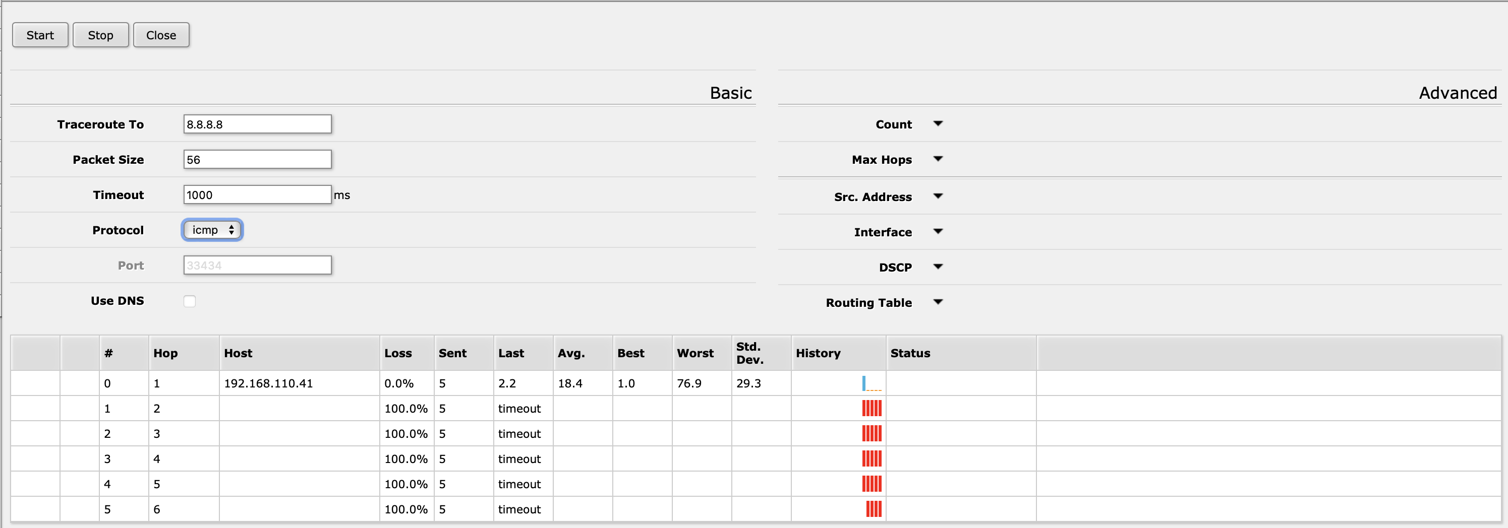

Also, when i try to trace route to 8.8.8.8 i see that we are able to reach 192.168.110.41 which should be one of the uplinks but it does not go beyond that. please see attached screenshot
