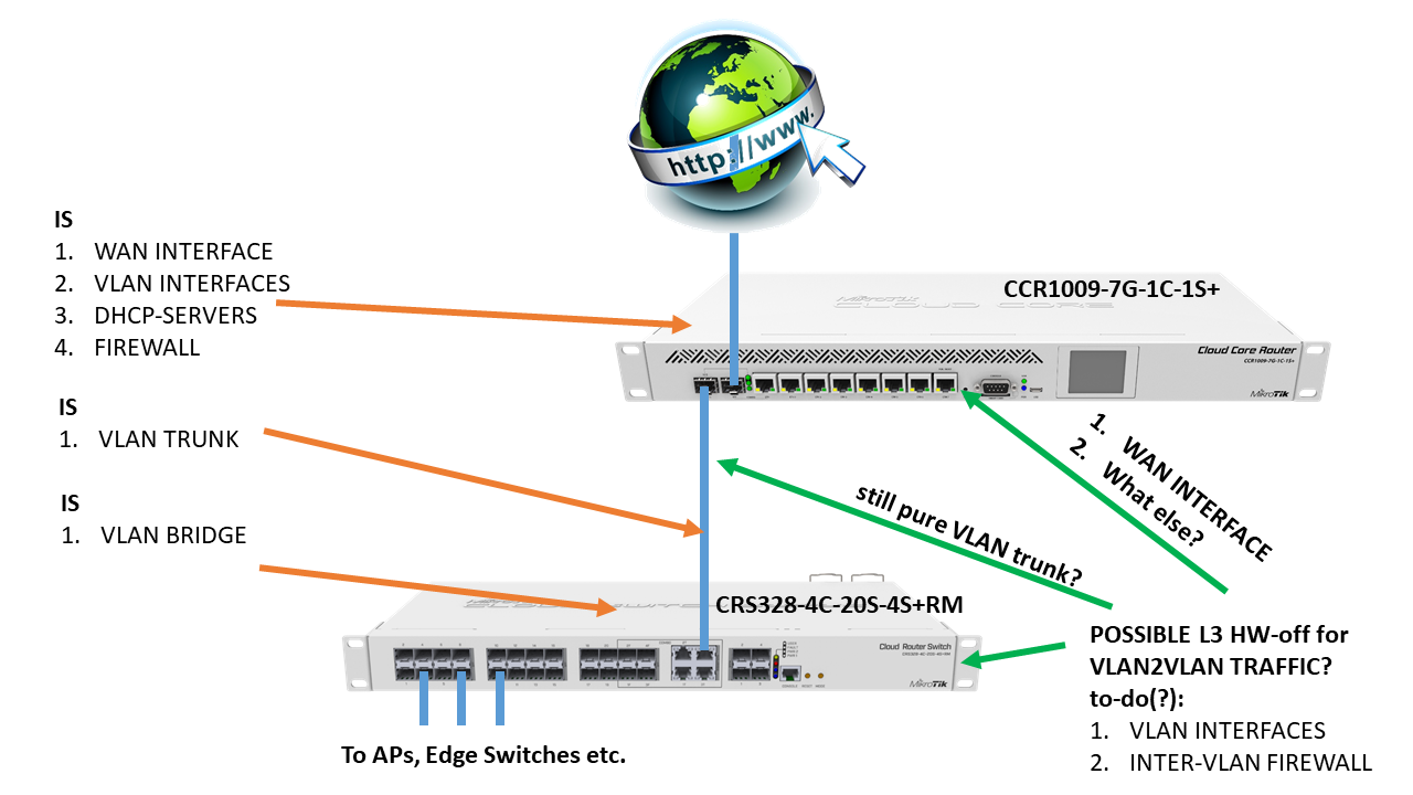

as from ROS 7.1 my CRS328 would be capable of Layer 3 Hardware Offloading (L3HW).
So I’m wondering if I will reach wire-speed in inter-VLAN-communication when I move the VLAN Interfaces from my CCR1009-7G-1C-1S+ to my CRS328-4C-20S-4S+RM to
As I don’t have spare devices of these devices I’m not able to test it as they are within a production environment.
I would appreciate it if there is anyone who could share his/her experience and may share the right configuration.
Here is a sketch that may help to understand my intention:
