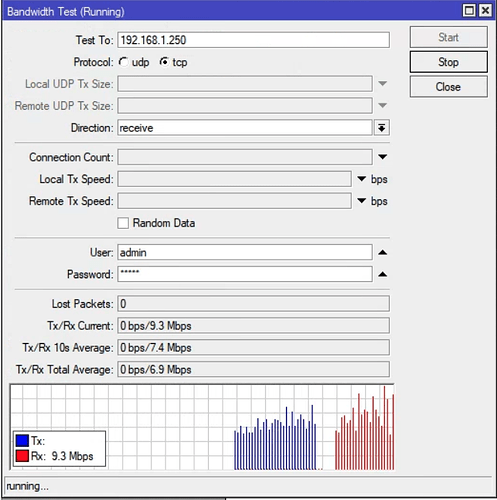

[img]
without creating too much problems to other 5Ghz users, I’m expecting 100-200Mbps
with your actual hardware, if all working correctly, i’m expecting at least 40Mbps
Currently my Signal looks like this:
TX: 58 dBm - SNR: 41dB Stable - Noise floor -101dBm
RX: 62 dBm - SNR: 30-38dB fluctuation - Noise floor -96dBm
I tired 802.1a, Nstreme and NV2, nothing goes beyond 10Mbps.
Would my above signal explain that? or there is something strange here?
Thanks!!

I will check all your hints, but let me ask the question based on your experience, What is considered a good SNR to achieve 20Mbps?
If you where to switch to the card you posted you should be able to get 20mbps in a 10mhz channel no problem with the signal you currently have.
The SNR of 40dB and 38dB are great
When ruining the built in speed test your CPU tends to be the limiting factor
