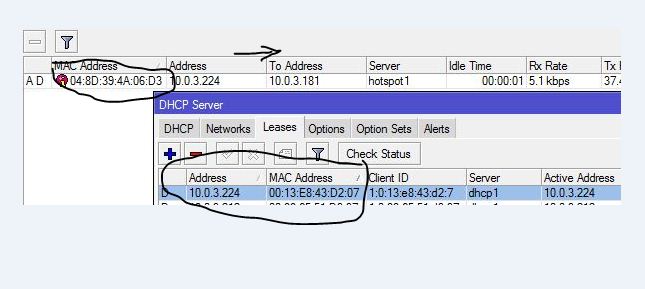

mik--lan->ap--->repeater ap----->client( issues)
my network uses hotspot on a first ap and a second repeater ap
when client connects to main the client mac is shown
but when client conects to the (repeater ap) the client mac is not shown and all clients who use (repeater ap) get the repeater mac on hotspot hosts list {ADDED A PIC}
can this setup cause any bugs or unstable network use for clients ?
Mac address is layer 2. It is, if I understood correctly, only from router to router passed. For me, therefore, your network works. The router should only transmit its MAC address.

after testing this setup only one bug found :
WHEN dhcp add arp for leases is on
and a client gets an ip lease from the repeater
the client cannot use the main ap until his dhcp lease removed
this was resolved by (dhcp add arp for leases OFF)
