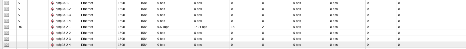

I have a CRS518-16XS-2XQ-RM and Intel E810 CAM2 NIC,
But QSFP28 port is split into 4, which causes the highest speed I can achieve is 10G, how can I “merge” them together so I can actually achieve 100G?
When I turn auto-negotiation off to 10G, the link will be up, if I change it to 100G, the NIC link will be down.

Disabling QSFP 2-2, 2-3 , 2-4 don’t work as well, completely clueless…

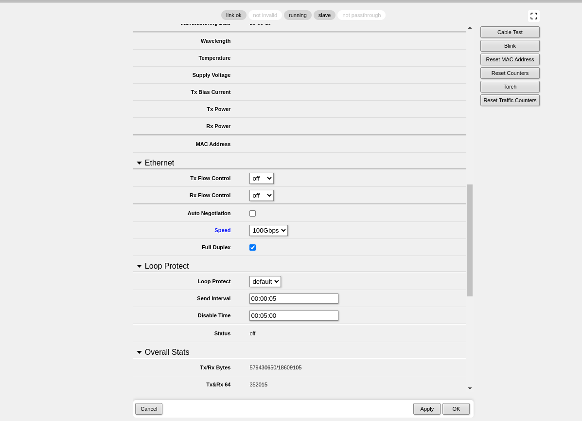

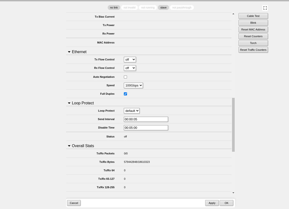

You mean turning the auto-negotiation off on the first interface and setting it at 100G right?
The moment I did that, the link dropped
