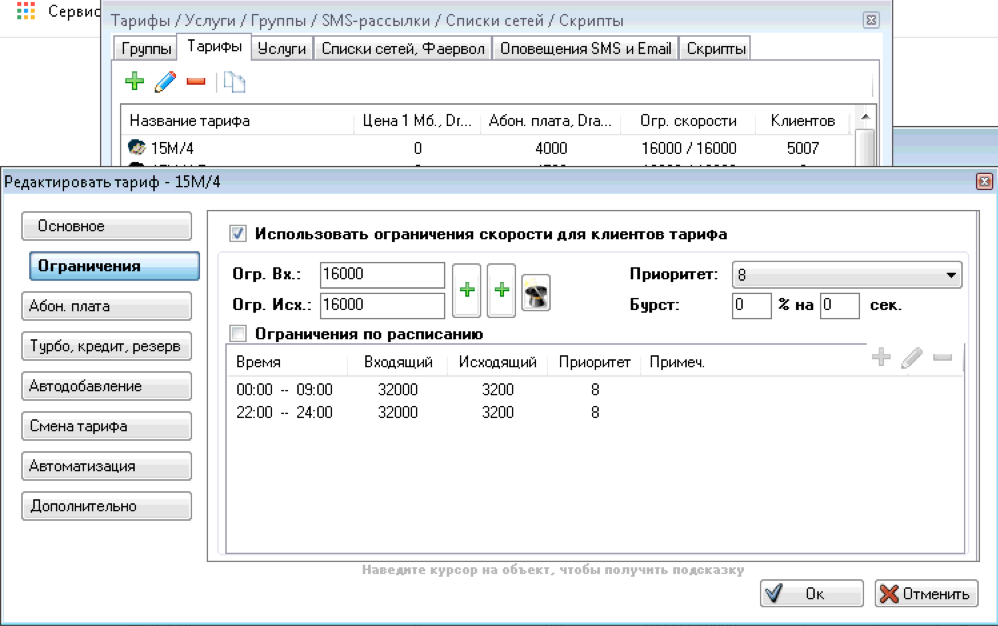

We did try fasttrack and total cpu usage dropped to 20%, however now the problem is that bandwidth limiting doesn’t work.
I’ve added the screenshot of the rule that we use for about 5000 clients.
