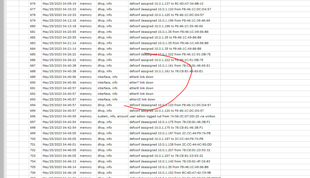

i have problem with my mikrotik 4011rb. everyday my slots eth 6-10 just suddenly drops down ( link down ). I even bought new mikrotik and problem is the same. Can you help me find issue? After reboot it works fine, but after about one day it happens again. I attach log file.

Could it be related to the DHCP offers?
