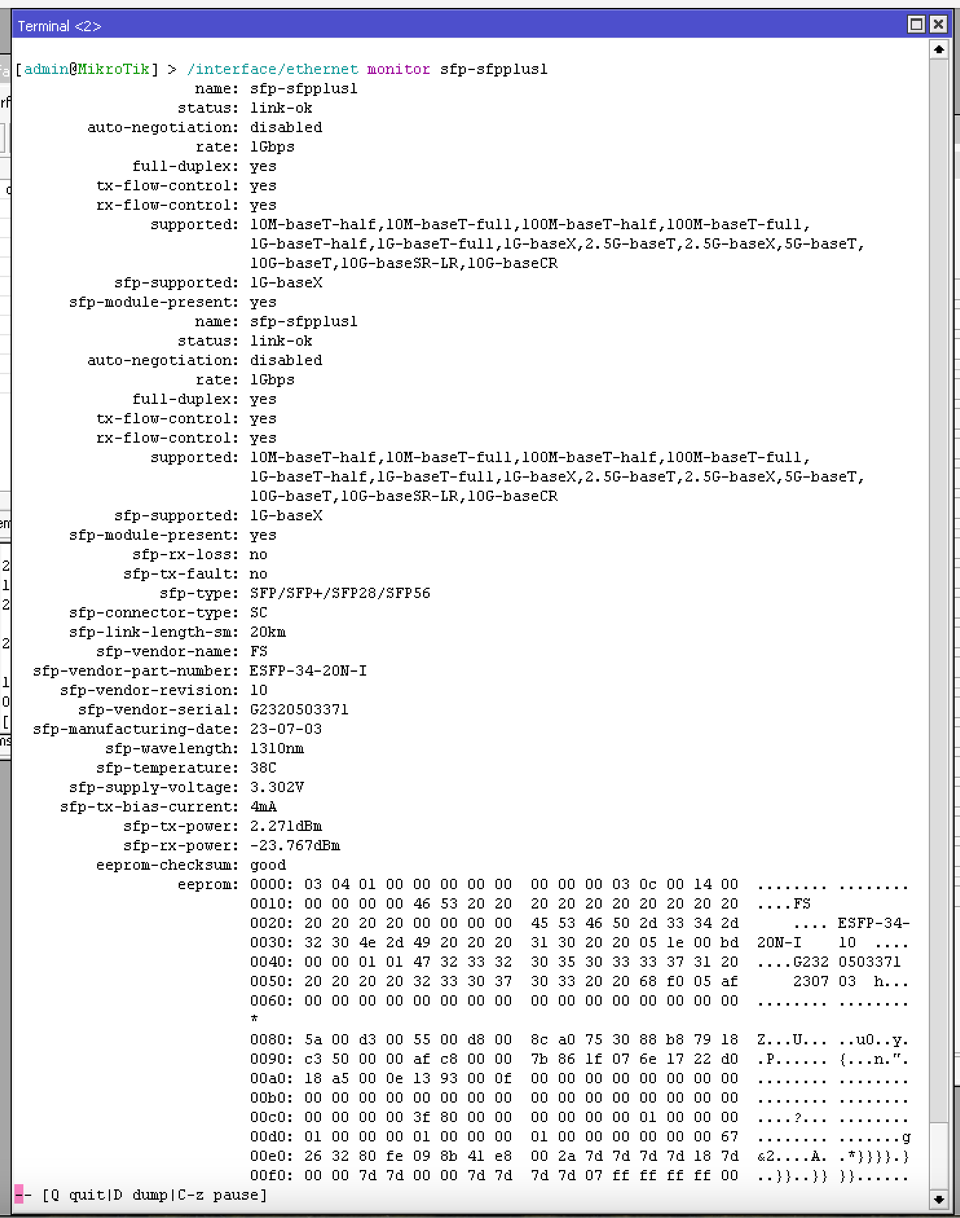

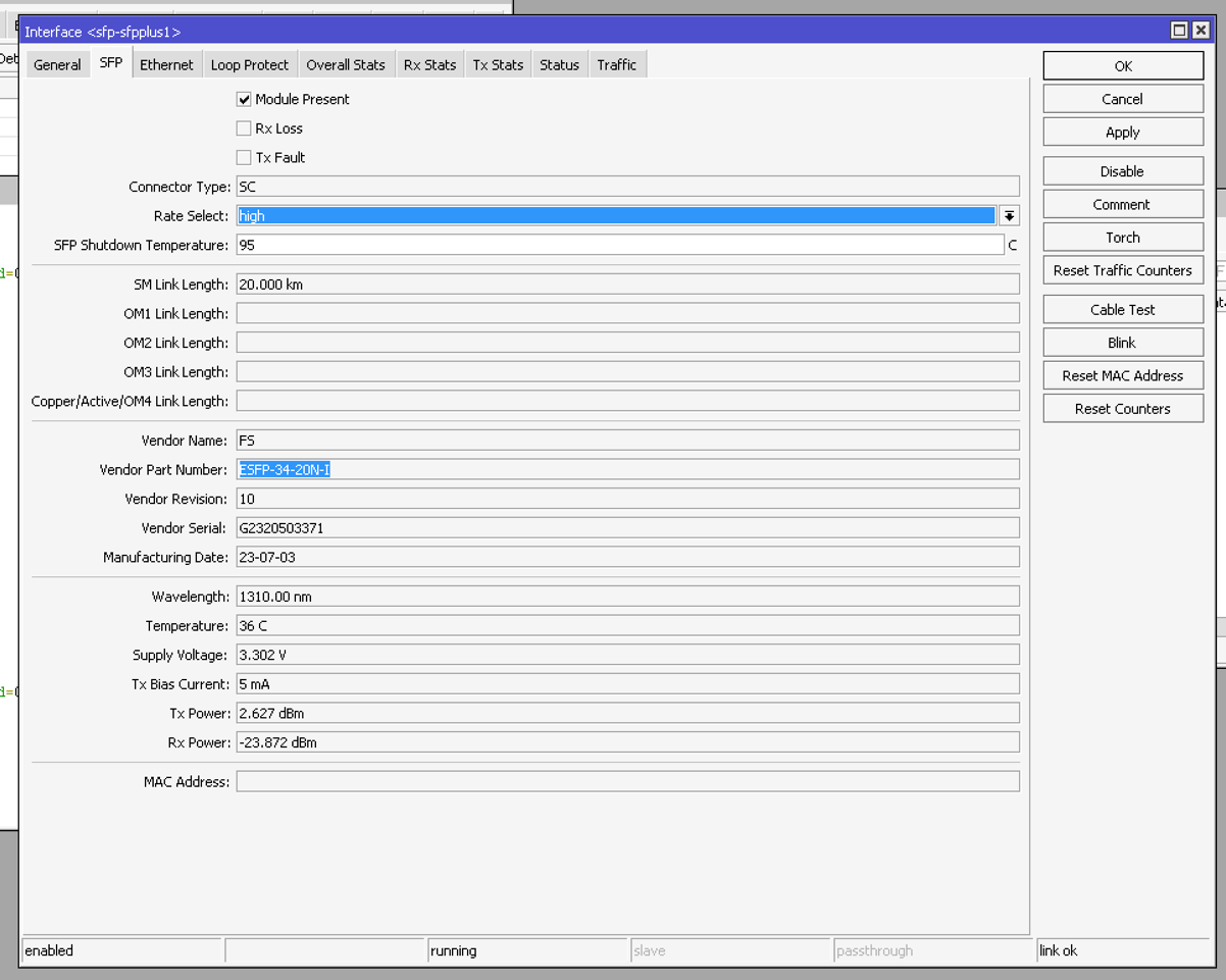

Router can perfectly see the module and read it’s info.
But connection is not established. :frowning:

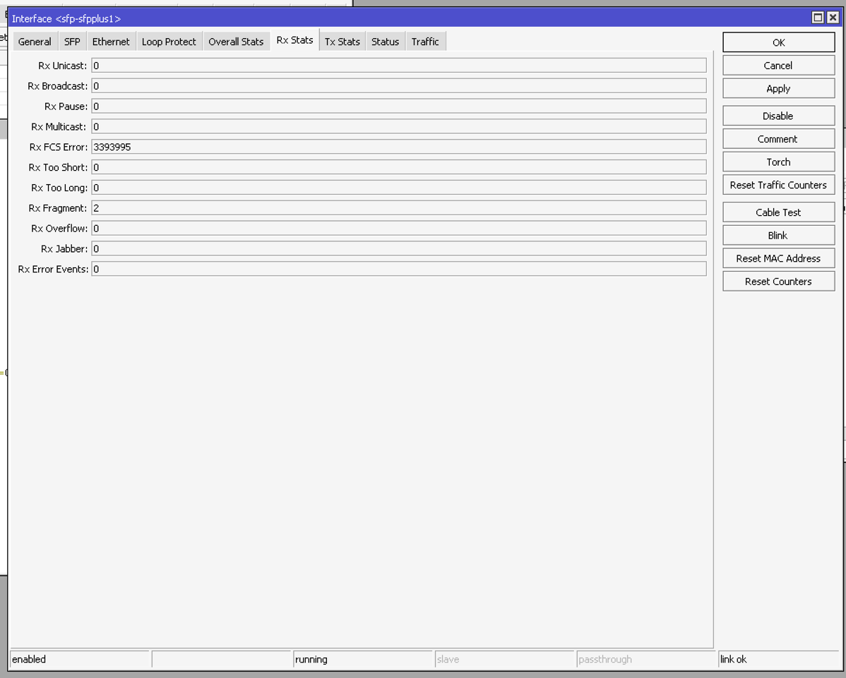

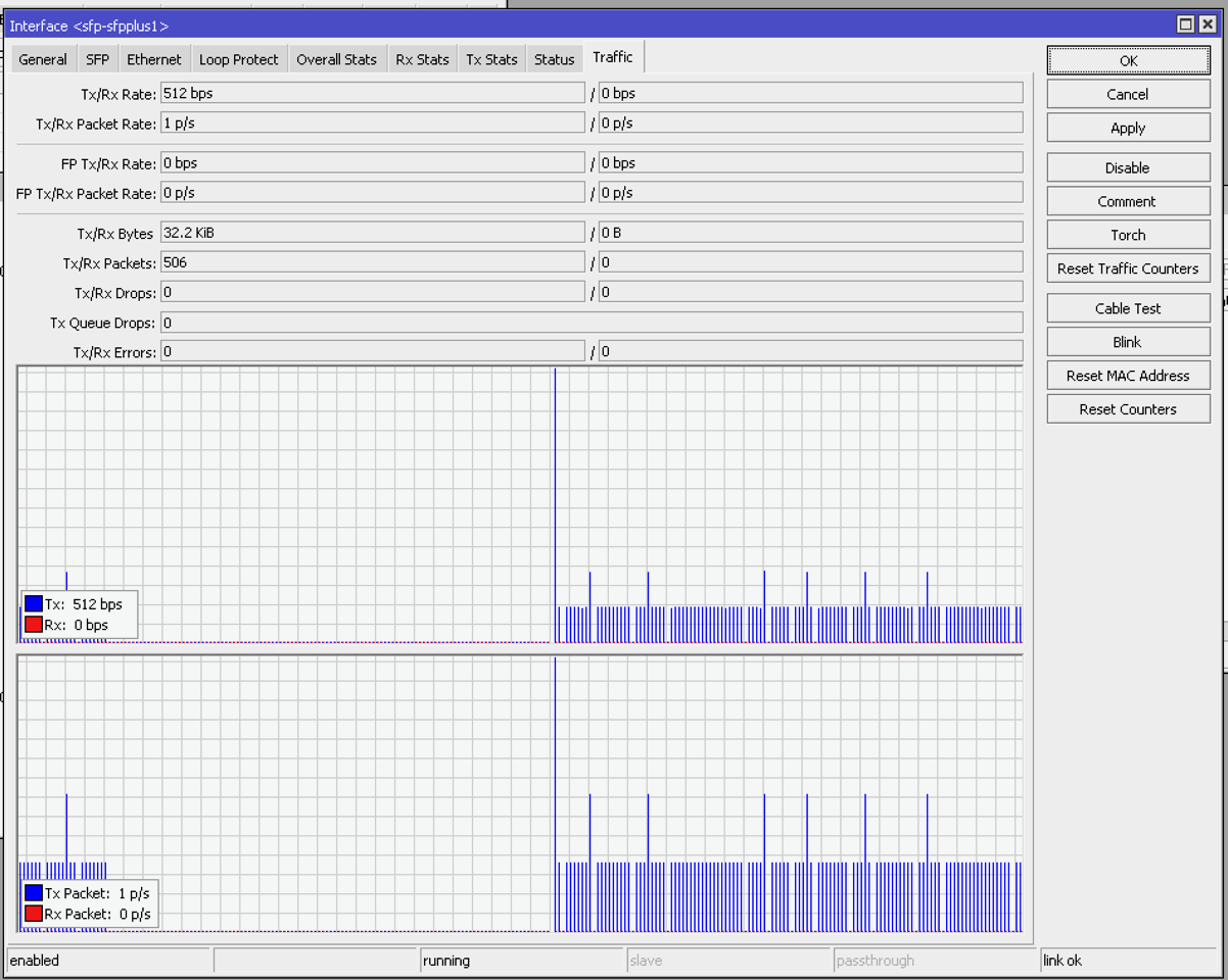

It just constantly generates Rx FCS Errors :frowning: and could not receive anything.
Would appreciate any ideas how to troubleshoot it.
