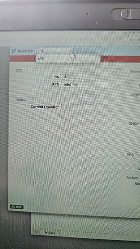

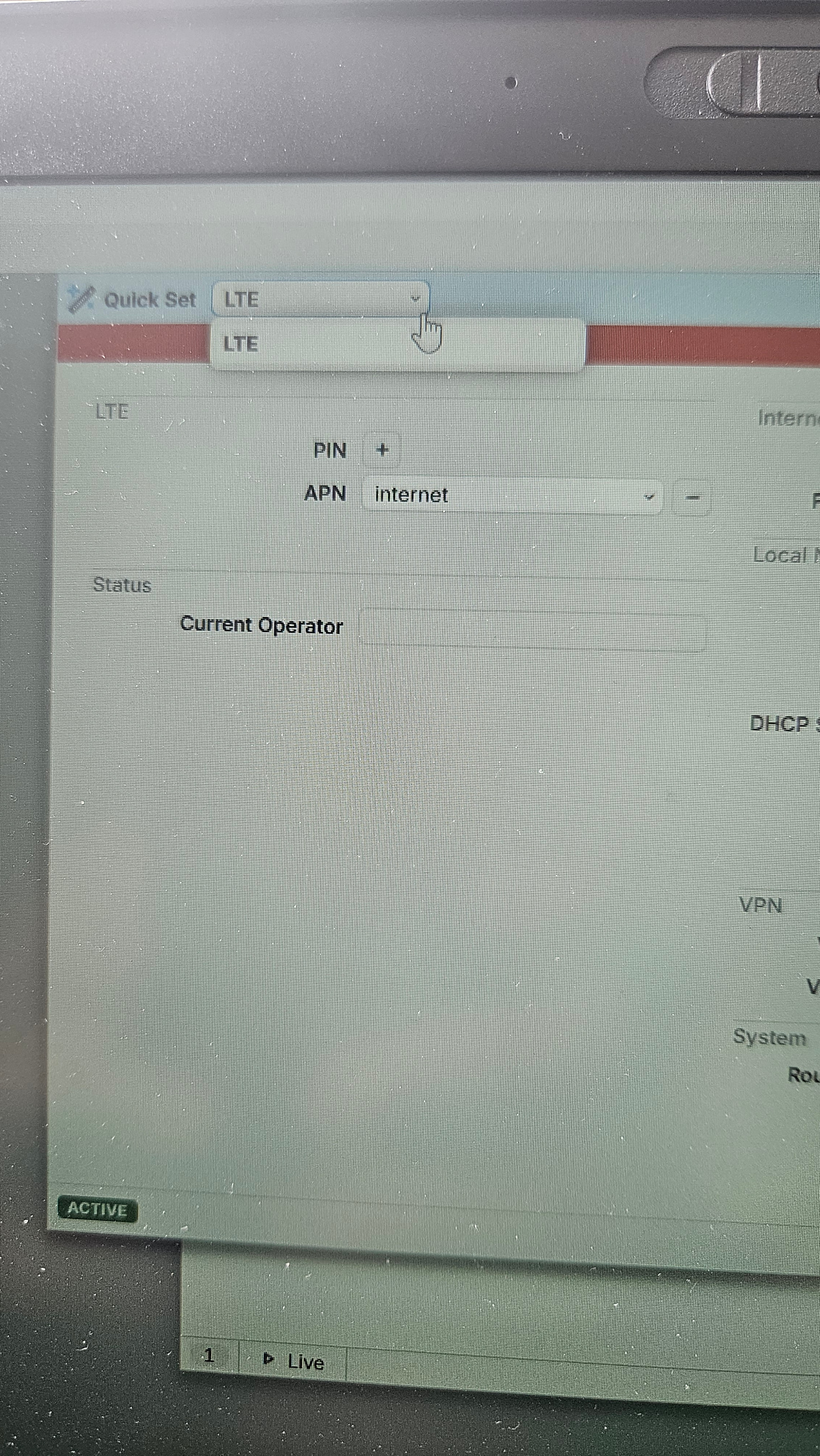

So I did a netinstall to 7.23.1 and now there doesn't seem to be any wifi and theres only LTE option in this drop down. There was another option here before the update which I was able to select where everything appeared to be working normally.
Is there some kind of bug or did I flash something wrong? Thanks
Is the wifi-qcom package installed?
Just literally installed. I remember they were separated a while ago. Re-installed fw and QCOM ac and seems be working. Also have the option back in the drop down.

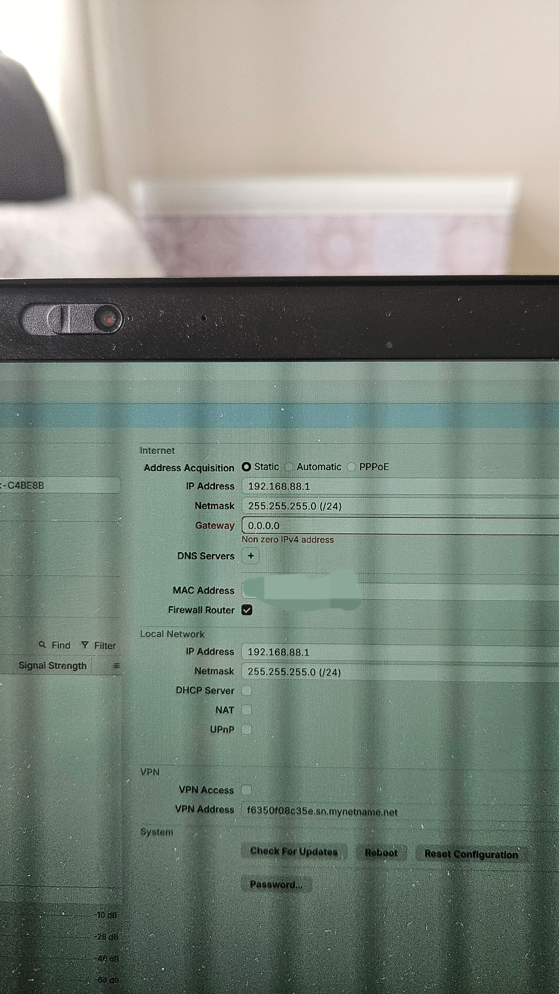

Should I change from static to automatic and on windows set the obtain IP address automatically again?

I see in your screenshot photo (why not use a screenprint?) I see you are setting WAN ip address. From the information you filled in it looks like you are mixing up WAN and LAN. Perhaps reset the device to defaults to have a better starting point? And be aware that Quickset is only for initial configuration, afterwards you should forget...completely.

That static IP on the "internet" section is certainly wrong. try "Automatic".
