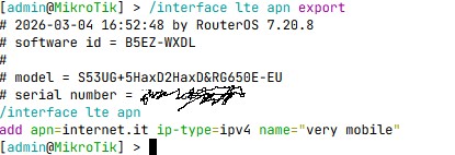

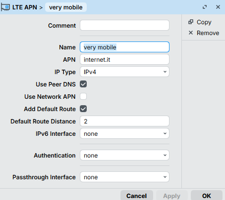

tried forcing “internet.it” APN (correct apn for very mobile ISP) (pic provided) but no luck.

Sometimes there is a disalignment between GUI and terminal with "use network APN".
Open terminal and run in it:
/interface lte apn export
you should get:
/interface lte apn
add apn=internet.it use-network-apn=no
I got this output. Hope there is some advanced user from italy of this particular device that can help me sort things out… the settings are mostly default configuration, i modified only LTE settings and wi-fi (and system clock/date)
maybe this is the cause of the issue? Why init modem with modem config query command?

The default for use-network-apn is "yes", so if it doesn't show it is still "yes".
Then issue:
/interface lte apn
set [find name="very mobile"] use-network-apn=no
And try again with:
the export should contain the "use-network-apn=no"
