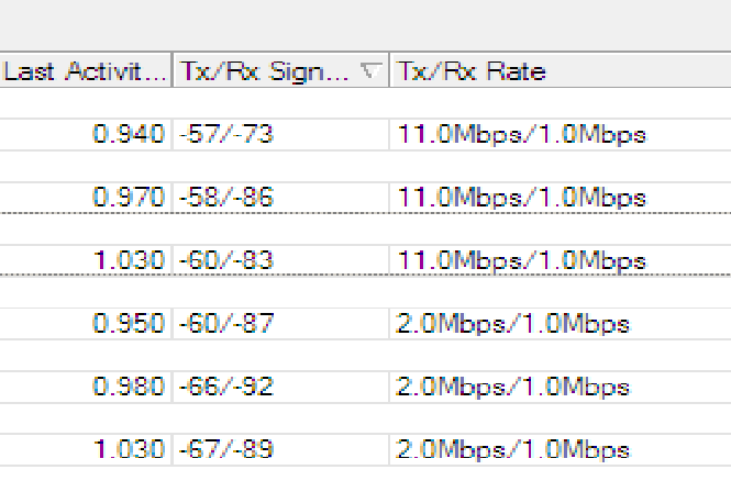

I have attached an mikrotik 5hn groove to an 5.8 omni for an AP. TX is good but RX bad. Can`t connect clients with any signal strenght in the -70 up worths.
how can i better that, or is the groove faulty?

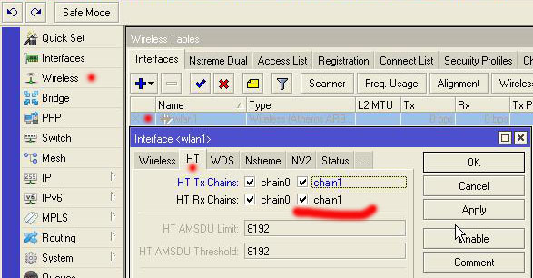

Hallo, have you by “wireless” “ht” all the chains activated?
Go to “wireless” after that klik on wlan1, click on “HT”
See the printscreen that i made, actived all the chains
