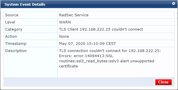

15:05:47 echo: radius,debug RADSEC: failed to setup connection: handshake failed: unsupported certificate purpose (6)
15:05:48 echo: radius,debug timeout for 0d:5f
[admin@tikki] >
but my certificate is crap … “unsupported certificate purpose (6)” … nice … on server ? … on client ? … both ? … and what purpose is it ( .. or not) ?
at least both sides agree about things in denmark
