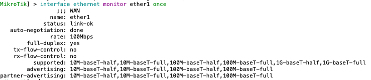

Today i was browsing the webfig of my router and opened the ether1 (wan port) settings and clicked on STATUS. It said that current rate is 100mbps, then below that
Advertising 10M baseT half 10M baseT full 100M baseT half 100M baseT full
Link Partner Advertising 10M baseT half 10M baseT full 100M baseT half 100M baseT full
So while i noticed that “link partner” is not advertising 1gbps, i did also notice that mikrotik is also not advertising the 1gbps capability.
I checked other ethernet ports and in all of them mikrotik does advertise 1gbps even if end device only supports 100mbps link.
So before i contact my ISP, i would like to sort things out on the router side first.
Are there any special settings i need to set/change in the router for it to start advertising 1gbps link speed on the wan ethernet port?

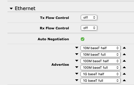

thank you, i found this advertising setting and it indeed has 1G half and full as you mentioned.
While i can’t change the cable (runs under floor) i will try to plug it into another port tomorrow and see if anything changes.

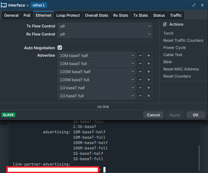

But for some reason, the Supported list of speeds is not shown in the Winbox GUI; can you open the Terminal window within Winbox, type interface ethernet monitor ether1 once in it (followed by the [Enter] key) and paste the output here? The point is that the configured advertise list cannot override the supported speeds as indicated by hardware, so if the hardware indicates just 10M and 100M, @gigabyte091 may be spot on with a hardware issue of a particular production batch. But before jumping to conclusions, what versions of RouterOS and firmware (these are two different pieces of software) are you running on the hAP ax²? Maybe a firmware update is enough?

Under System→RouterBoard menu, i see “Current firmware: 7.13.4”, “Factory firmware: 7.8”
When inside the console it says RouterOS is also version 7.13.4
Seems that you have autonegotiation set to on as on the picture we see "Auyonegotiation: done".
It suggests that MT advertises only speeds acceptable by other side.

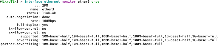

But on ether3 i have a iot device which definitely does not support speeds above 100mbps, but even though it says negotiation is done, mikrotik still advertised its 1gbps capability (as far as i understand the output of this command)
Nope, setting auto-negotiationto yes just allows the link speed to be negotiated. Each party advertises all modes it supports and are enabled in configuration and they both choose the best one they have in common. Look here:
[me@myTik] > interface/ethernet/monitor ether3 once
status: link-ok
auto-negotiation: done
rate: 100Mbps
full-duplex: yes
tx-flow-control: no
rx-flow-control: no
supported: 10M-baseT-half
10M-baseT-full
100M-baseT-half
100M-baseT-full
1G-baseT-half <---
1G-baseT-full <---
advertising: 10M-baseT-half
10M-baseT-full
100M-baseT-half
100M-baseT-full
1G-baseT-half <---
1G-baseT-full <---
link-partner-advertising: 10M-baseT-half
10M-baseT-full
100M-baseT-half
100M-baseT-full

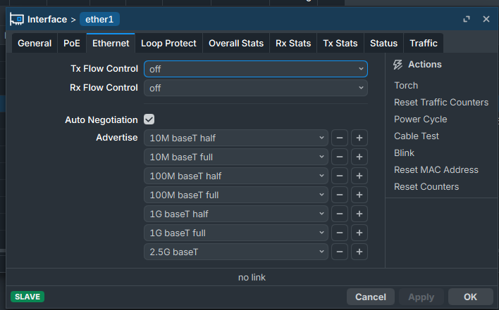

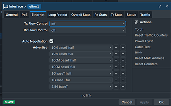

Do you actually have 1gig advertising enabled?
Default:
Changed:
Yes, i believe the setting is correct
