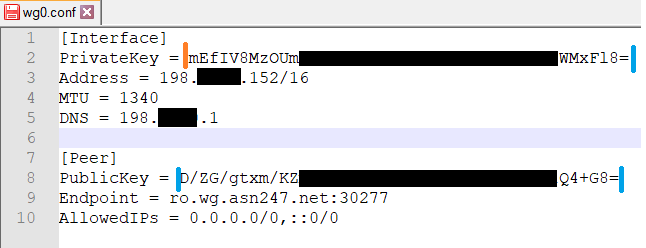

  3. Download the configuration and open in something like notepad++
  4. Open up the wireguard configuration.

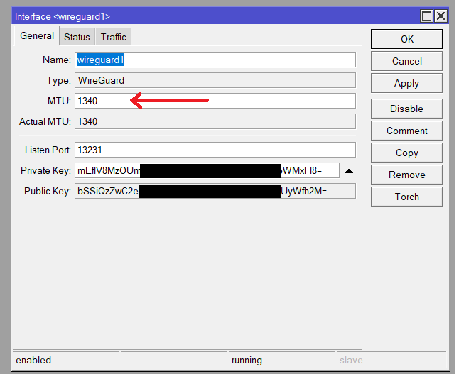

    Load the details in for the wireguard interface.
    Note :You need to the = sign in at the end of the Private Keys section. The MTU size from Astrill is only 1340 bytes (when I wrote this) change that as per the text file.

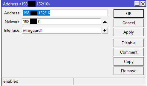

  6. Configure the IP address for the wireguard interface
    Now you should be able to “ping 8.8.8.8 interface=wireguard1” from the terminal.

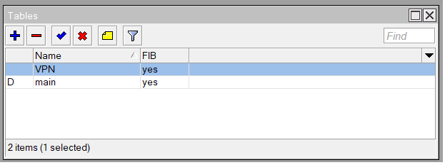

  7. Routing > Tables
    Make a separate routing table, call it what you like.

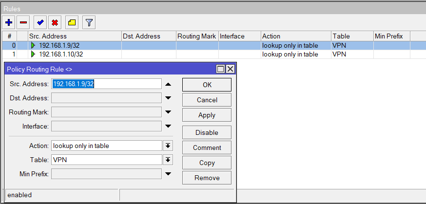

  8. Make rules to direct the traffic from device to that specific routing table you just created.

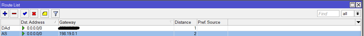

  9. Add a default address.
    This is a little bit of guesswork since the Astrill file contains no routing information. I manually created one and set the gateway as the same address as the DNS server, it seemed to work.

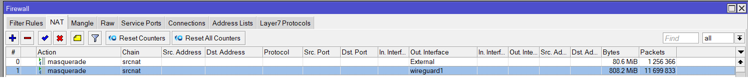

  10. Finally a masquerade rule in the firewall.
