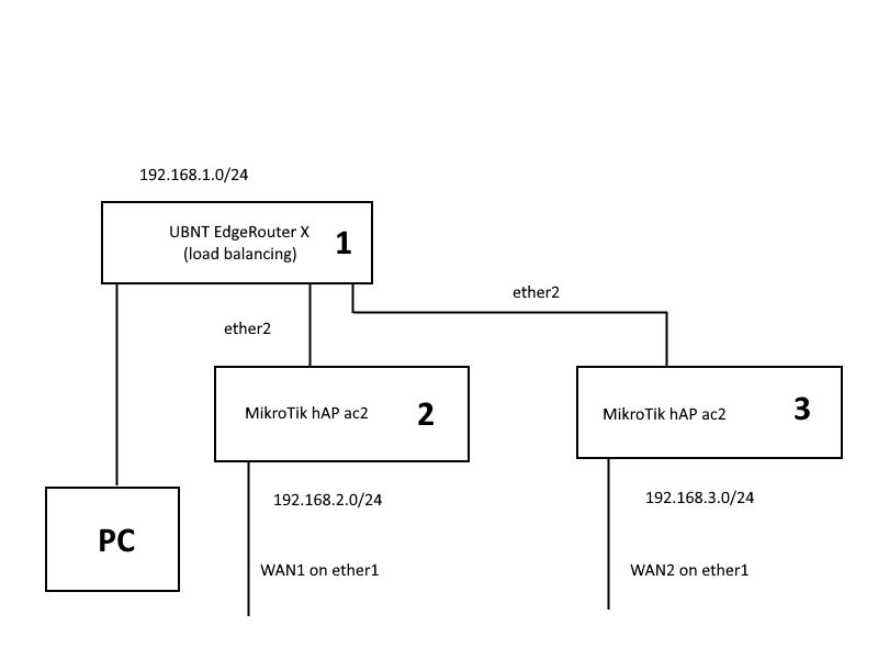

I need help with the following task. I have 3 routers (see scheme). EdgeRouter X is already configured, IPS of LAN2 and LAN3 are accessible from LAN1. 192.168.1.1 (LAN1) is not accessible from LAN2 and LAN3. How to configure MikroTik routers to access the EdgeRouter’s LAN?

You guys are clairvoyant and have far better networking acumen than me (as I have proven many times) because the diagram is not so clear for me. :frowning:
The way it reads for me is that the ISP traffic comes in on the HAPACS with each having their own LANS, which then feed into ports on the edgerouter (which does not seem to have any ISP provider connections WAN comes from hapacs).
Since the chap mentions all as routers I am assuming that the Edgerouter gets ISP1 traffic through hapac2 on network of hapac and ISP2 traffic through hapac3 on the network of hapac3…
These are WAN inputs to the edge which has is its own lan. The edge router load balances the two WAN connection (one each from hap acs) for its own network.

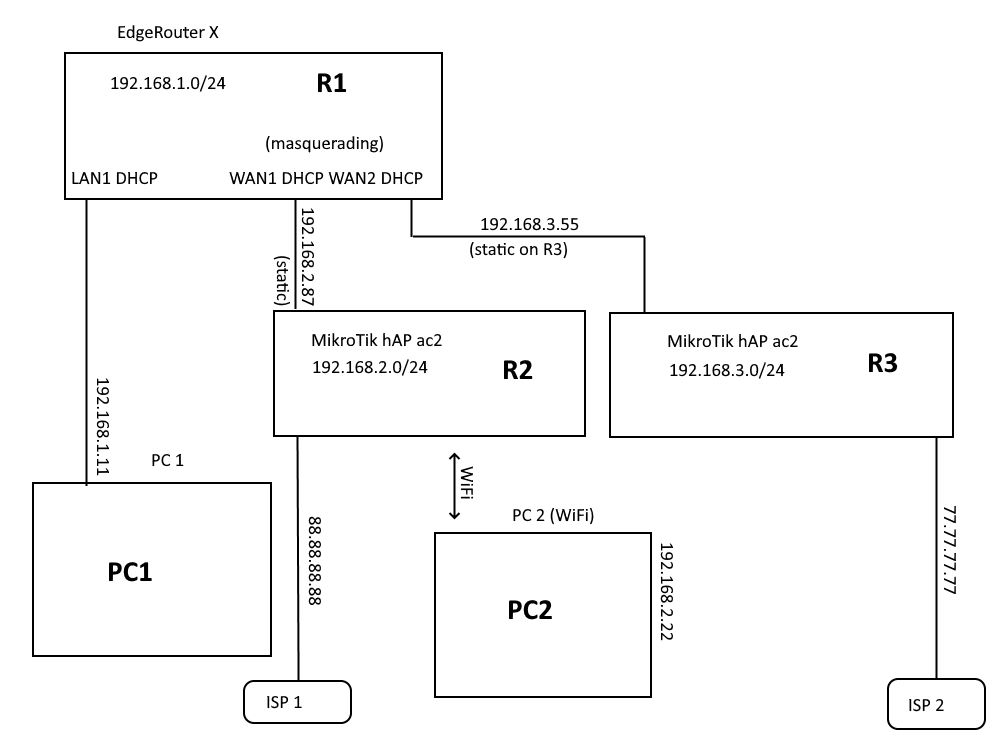

Here is the schematics. I have access from PC1 to any networks (R1, R2 and R3). I need access from PC2 to R1 network.
Hm…
If i catched this correct… all you need to do is add a static route on mikrotik for R1 network.
add check-gateway=ping distance=1 dst-address=192.168.1.0/24 gateway=192.168.2.1
Remember to configure firewall of edgerouter to accept connections from wan interface
If the missing route was the only change needed, then PC1 wouldn’t be able to access PC2 right now because PC2’s replies wouldn’t get routed back via R1 … so my guess is that R1 performs SRC-NAT when reaching out to R2 or R3 and PC2 doesn’t actually see PC1’s address but rather R1_WAN1 address. If that’s so, OP would have to reconsider where to actually perform NAT and for which destinations …
But that’s just guessing without actually seeing R1’s config.
I think i found the problem…
When PC1 tries to reach PC2 then the trafiic gets src-nated with the routers Wan 1 address.So 192.168.1.11 (PC1) → src-nat to routers address lets say 192.168.2.1 → 192.168.2.22 (PC2)
When the packet returns from PC2 it will go to 192.168.2.1 the router wiill remove the src-nat applied before and finally 192.168.1.11 (PC1) gets his answer from 192.168.2.22 (PC2)…
However, the other way around, when PC1 starts a communication with PC2 then 192.168.2.22 (PC2) will reach 192.168.1.11 (PC1) but on the way back PC2 will get an answer because of the masquerade from the router 192.168.2.1 and not from 192.168.1.11 as it expected thus marking the connection invalid and dropping it.

SOLUTION
MT1:
Add route 192.168.1.0/24 192.168.2.87
MT2:
Add route 192.168.1.0/24 192.168.3.55
ERX: Firewall/NAT → Firewall Policies
WAN_IN drop → accept
WAN_LOCAL drop → accept
