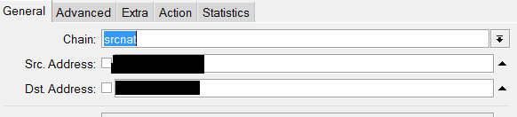

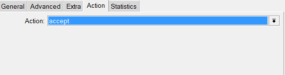

IP Firewall NAT Config
I need assistance in configuring a stable VPN connection. My Internet is ok, the other configuration is just masquerade for the internet. This seems to be a simple config but I wonder why its so unstable. Has anyone had any VPN connection that are successful even using other brands and Mikrotik on more than 5-10 Tunnels wherein nothing changes when you restart.
