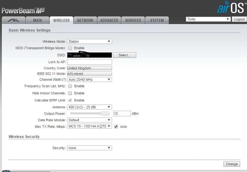

I never configured anything different than some basic wireless and network parameters. I have the pics of the ubiquity wireless interface here.

Post screenshot of
  1. MAIN page of UBNT
  2. Wireless/registration/signal tab on Mtik from winbox for CPE in question…
