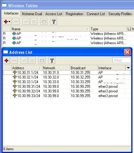

Hi boen_robot,
I have one problem with Mikrotik address list.
We have three AP, with three ip address in one mikrotik.
Everyone AP have ip address.
AP 1 - 10.30.31.1
AP 2 - 10.30.32.1
AP 3 - 10.30.33.1
We have MySQL database where are ip address and mac address our clients.
How I can create php script, if I mac address:
  • exists in mysql and mikrotik → do nothing
  • exists in mysql and not exists in mikrotik → write mac address to address list
  • not exists in mysql and exists in mikrotik → delete mac address from address list
Thank You!
