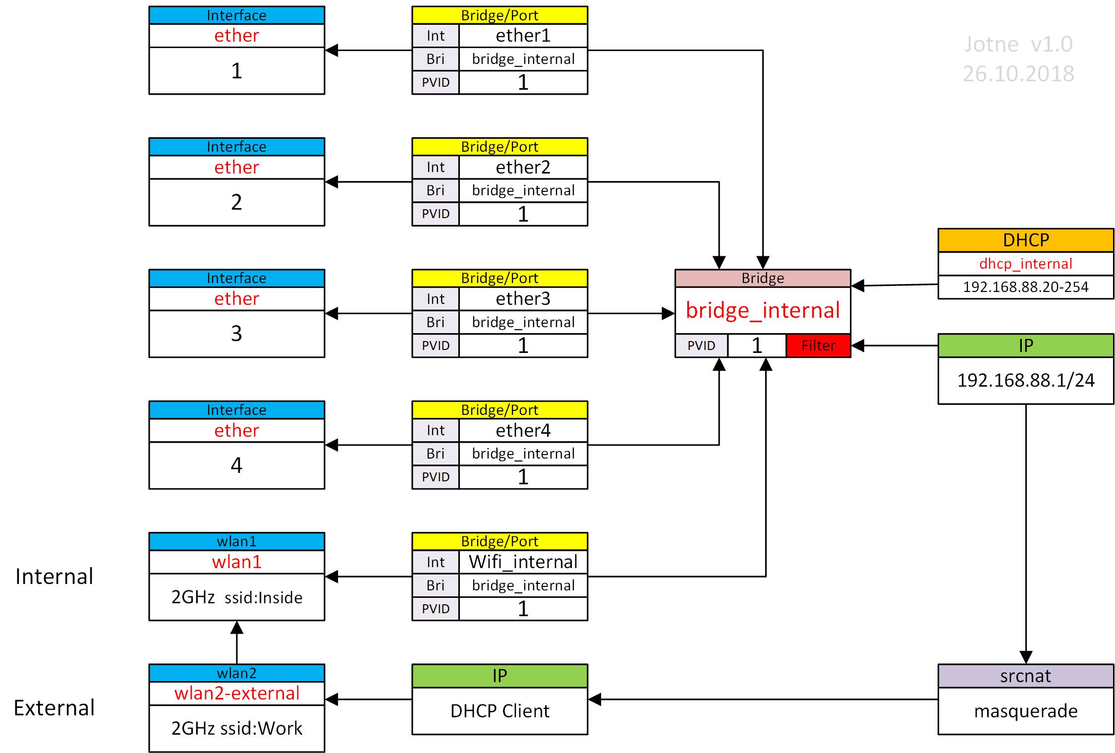

Both solution do use NAT, so your Wifi does only see the MT Router and no client hidden behind it.
This will connect to a wifi network and share it out both on wifi and on the swithch ports.
External Wifi in this test is Guestnett no security
Inside Wifi ssid:Inside wpa2 ssid:Test1234

Here is the same setup, except this does connect to an encrypted network.
External Wifi in this test is Work wpa2 ssid:Secret1

Here is how it looks like in a block diagram.
