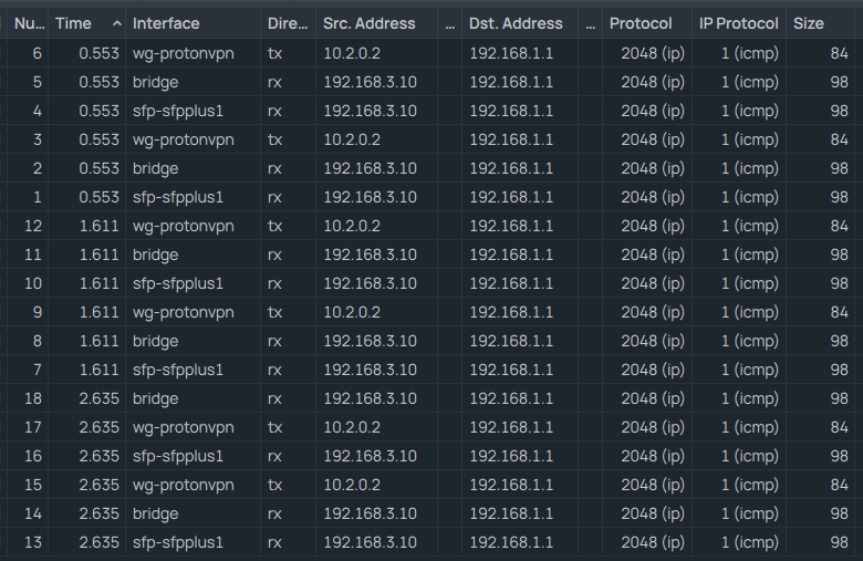

When I do packet sniffing I see ~9 results per 1 ping from Ubuntu SRV (192.168.3.10) to MKT DNS (192.168.1.1). That's quite a lot -
I attach my MKT relevant config on pastebin: https://pastebin.com/LNxYH31r
tcpdump here: https://drive.shadow82.pl/s/5EGAD2nDiETwZYs
Is there some routing loop?
MKT doesn't know where to respond?
What am I missing here?
