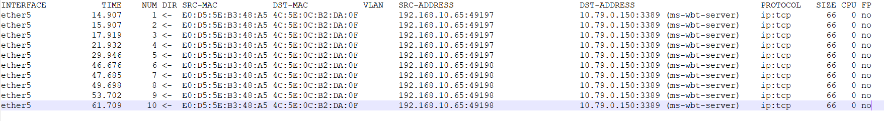

So it’s time to start sniffing. On the Mikrotik, make the command line window as wide as your screen allows and run /tool sniffer quick ip-address=10.79.0.xxx in it, run the telnet command on Windows, and post the output ot the sniffer.

Another blind shot: /interface detect-internet set detect-interface-list=none (and keep the use-ip-firewall set to no as well). The “detect internet” function has been reported to cause various kinds of surprises.
Unless you have removed something when posting the configuration, there is nothing in the firewall rules that could prevent TCP from being routed from bridge (ether5) to sstp-out1, whereas the sniff shows it is not forwarded (unless you’ve added some additional condition to the /tool sniffer command).
What does /ip route check 10.79.0.150 show?
sindy - thank you very very much for your help!
It’s my bad - I’ve noticed I had a NAT rule for RDP later on which I didn’t posted where I didn’t put an Input interface on it and it was applied for all RDP traffic internally and externally and that’s why I couldn’t go through Mikrotik via RDP.
