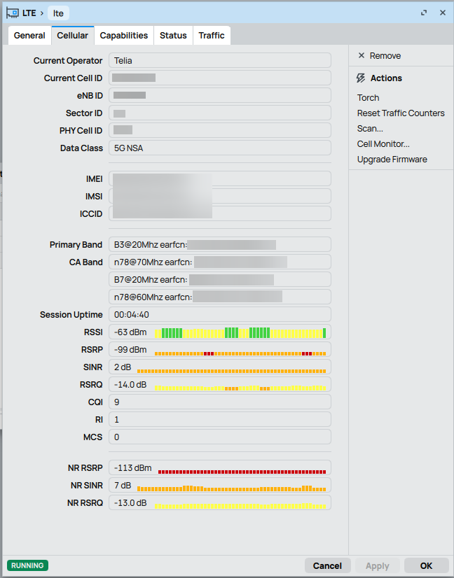

In my case, bad upload is due to far distance from cell, bad NR RSRP, I have 140-190/7-10 with this connection:

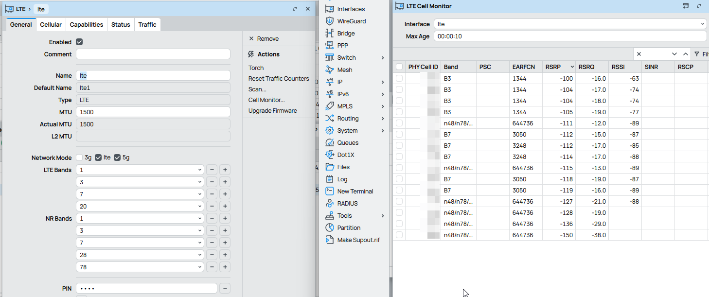

And one more question. If in the Cell Monitor I’m seeing the following picture — does this mean I selected the correct bands in the interface settings?

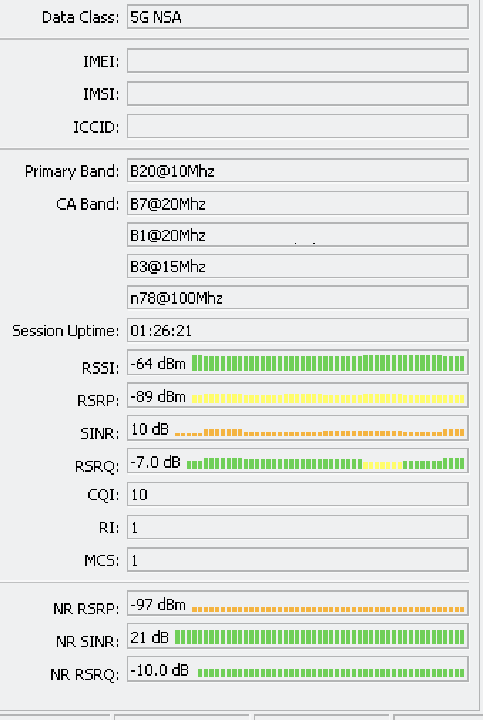

Your numbers look so green compared to mine…How far are you from the cell tower? Here are mine:

And there’s one more thing I don’t understand.Through the LTE Cell Monitor in the interface settings, I see many bands, and as already told me, monitor may include all operators. But maybe you know is there any way to show only the bands belonging to my operator?

Approx. 1.3km, you are much far, that’s why your antenna tx signal cannot reach cell with enough power to have better upload, see your NR RSRP. Unless you can somehow amplify signal above regulations you are out of luck with 5G for upload.

Regarding the screenshot with 4G/5G status: all shown bands are pretty high frequency (B3: 1.8GHz, B7: 2.6GHz, N78: 3.5GHz) so given your description of environment I'm not surprised by the lack of uplink performance (your ATL simply doesn't have the Tx power to overcome all the attenuation between it and cell tower). And no, I don't think that technology selection (4G vs. 5G) for band 28 would make any difference (because given same physical constraints, i.e. RSRP, RSRQ, bandwidth, etc., they both yield same performance ... main difference between 5G and 4G comes from additional bands, wider bandwidth and higher MIMO ranks, none of which works in low frequency bands such as B28).

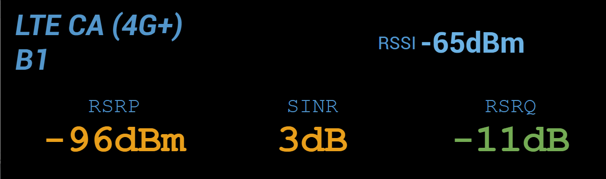

In my previous setup, I used a Huawei B525 + 2 Iskra antennas, which handled 4G speeds quite well. I’m still using this as a backup channel while I’m configuring my new equipment. And this setup is currently giving me the following results.
